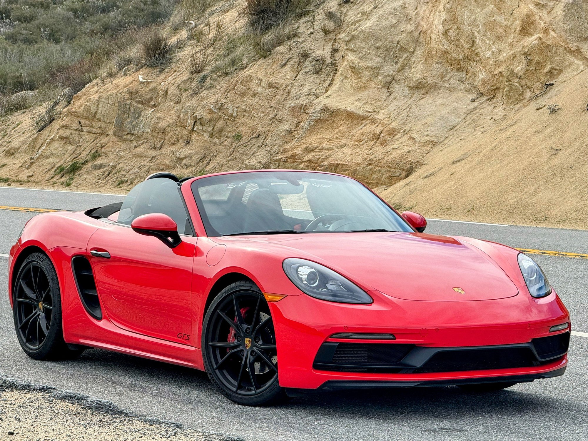

How much front camber do you have? With enough camber you can go 265 in the front with 285 in the rear, that's a nice combo and will solve your understeer concern.
That's what a 265 looks like up front, same wheel as you, just a different color. And, yes, my car is also a GTS.

The top picture wheels look great. Why are you changing?
