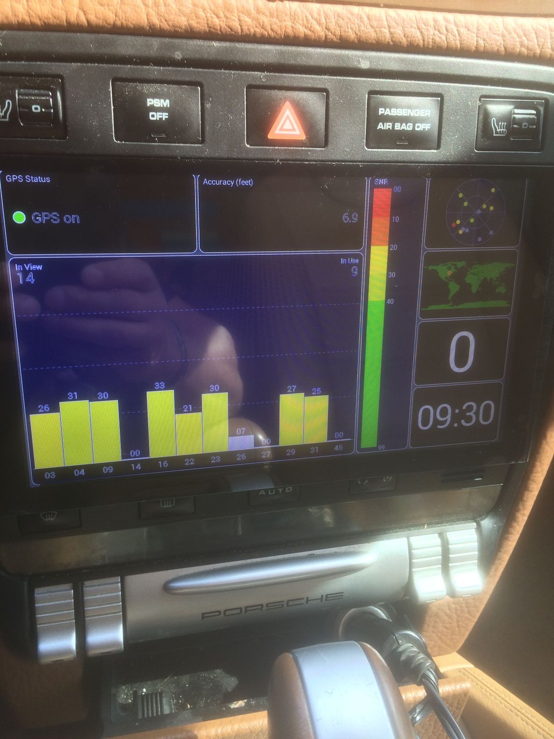

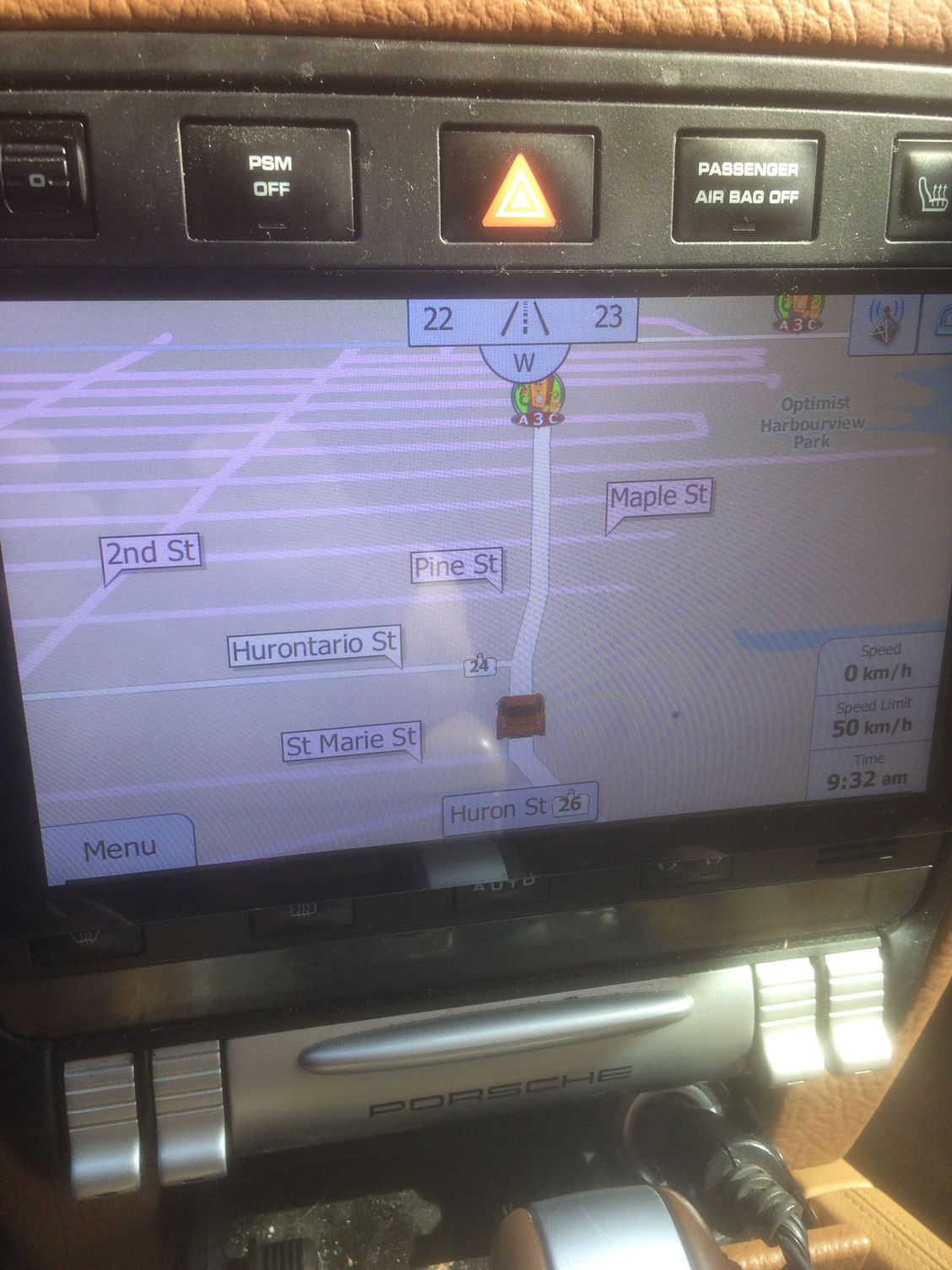

Turns out the GPS antenna they sent me was a signal amplified that was supposed to work with the antenna they sent me earlier. When I open the GPS Test app I see like 15 satellites now. But it is still unable to give me a location. Can anyone post a picture of the iGo screenshot and the GPS test app screenshot?
I don't know if I am doing something wrong.

Mine shows 13 satellites available, but no location, accuracy and everything else is zero.
That's very weird. If it detects satellites, there is no reason it shouldn't get GPS. Is location services turned on? Maybe a factory reset is in order?

This is what I see. no location...
It's weird to me that every single satellite is visible, and all at the same level. Mine looks like the picture above with varying intensities, and some satellites that are not visible.

Yea this is with a signal amplifier. Without the amplifier I don't see even one. Another thing is the signal varies a lot with time. One minute I see 10 satellites and the next 2. Is the signal stable for you?

Ok! I just bought a GPS antenna from Amazon and installed it. Now I am getting great signal without the signal amplifier even. I also bought a microphone. Seicane shipped really cheap antennas and microphones with their unit.
