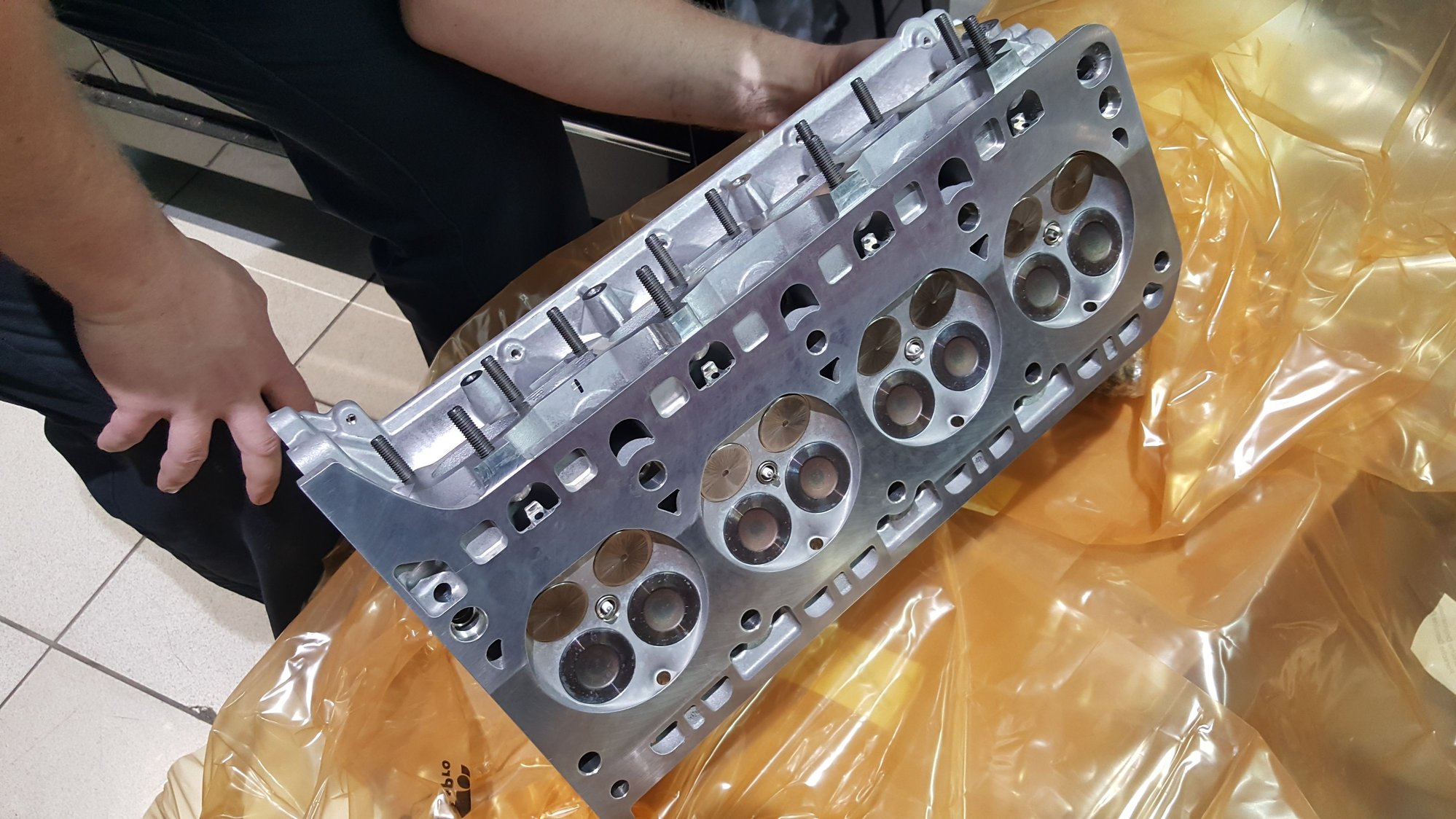

So my 2011 Turbo had this failure last week and is now in the shop. The failure damaged one of the oil feeds to the cam gear. Even though it caused small damage, the head has to be replaced.
New head
Easier to pull the engine to replace the head
