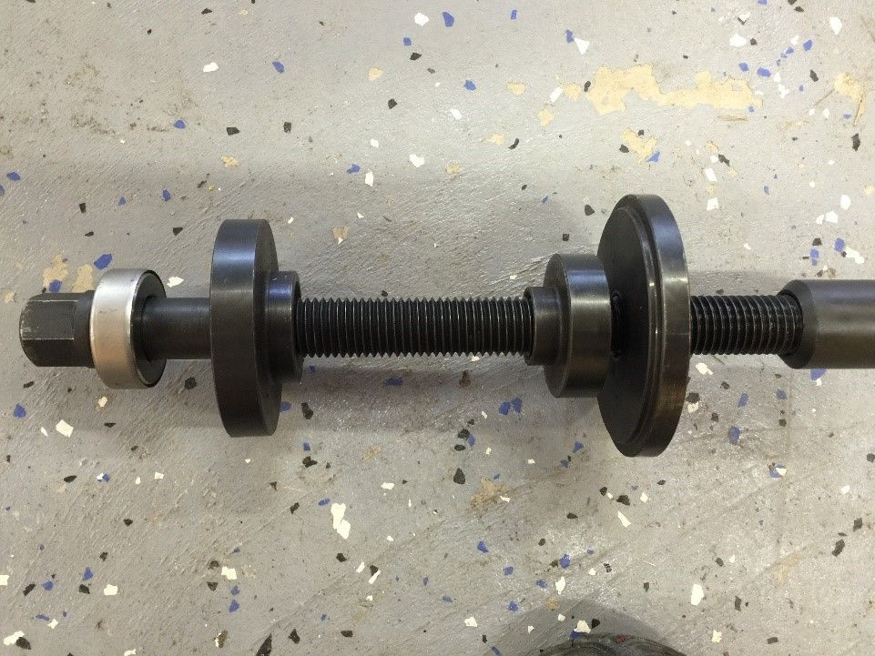

Using the AWorx tool again, setup as follows. The big backing plate goes on the inside of the wheel carrier. Orient the bearing with the red side in towards the car. The spacers in the middle hold the bearing in place nicely. Put wrenches on both sides and turn the left nut in until the bearing is seated in the carrier. MAKE SURE IT GOES IN STRAIGHT from the start.
