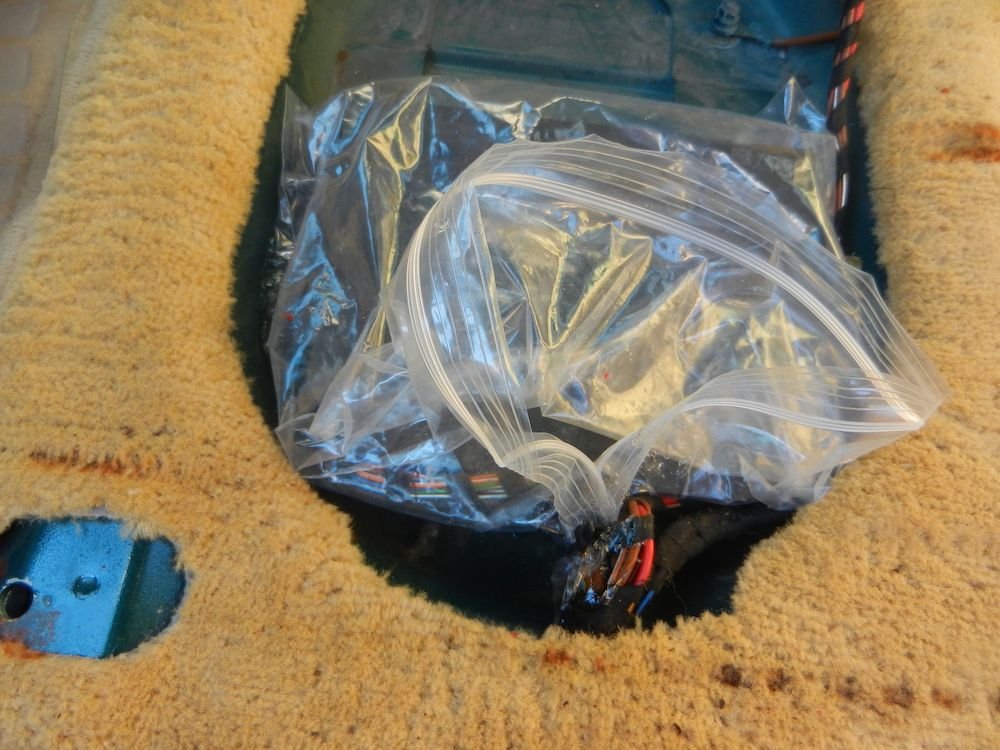

My solution for the immobiliser was to put it in a plastic bag... getting a tupperware or other container in the available space would be a challenge. The holes for the mounting bolts are sealed with caulking as are the wires where the bag is folded around them. I figure I am safe to about an inch over the box.
