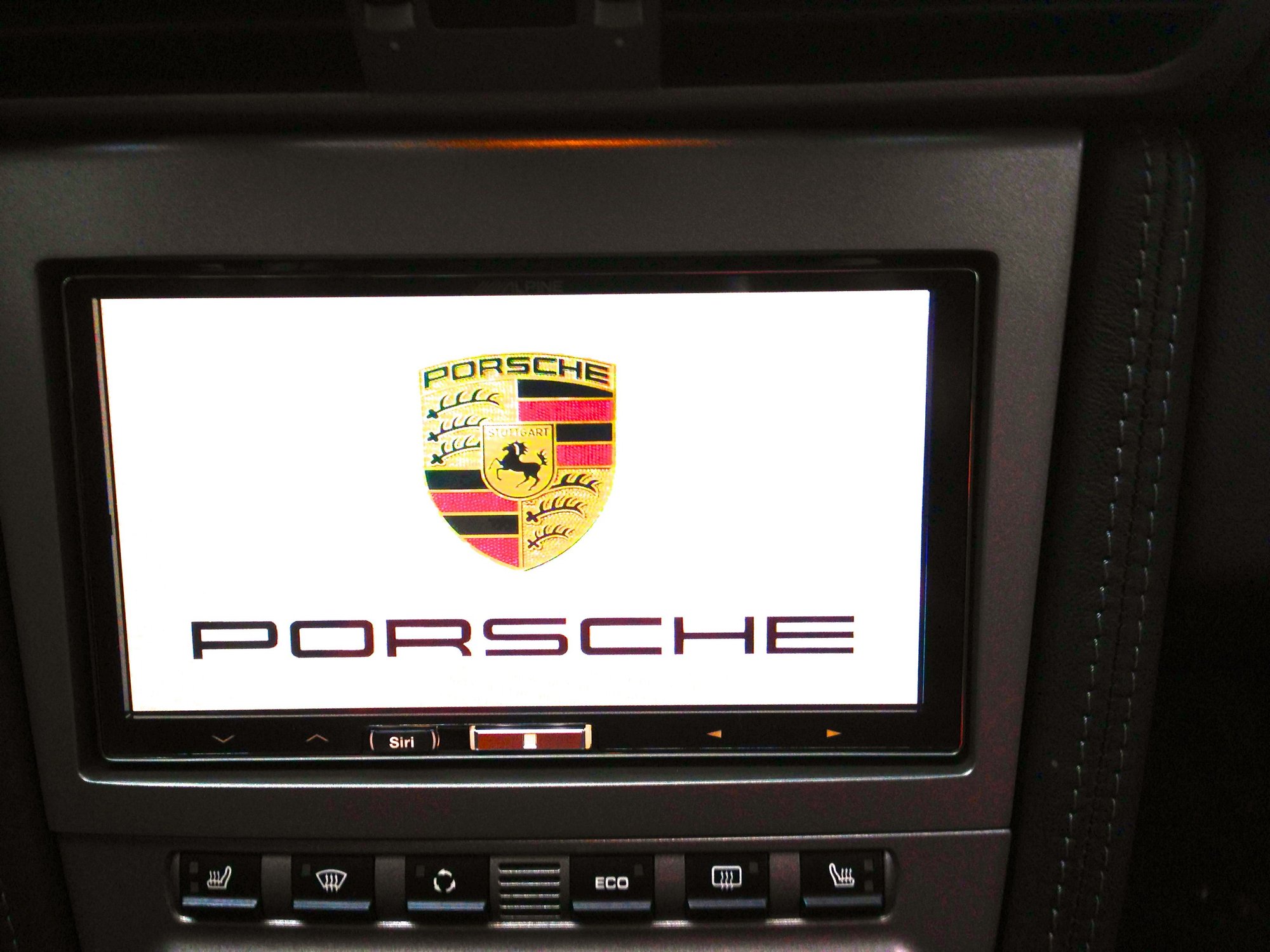

Its really easy. Theres only 4 trim panels total that need to be removed which reveal the side of the PCM. Two hex screws turned on each side of the PCM and it slides right out. Once your new head unit wire harness is wired to the NAVTV its plug and play. New unit slides in, trim bezel attached, throw the trim panels back on, then your rock'n and roll'n. I found the NAVTV and bezel kit from euromotorspeed on eBay for $750. If you get the head unit first and send them the wire harness, they'll even solder it for you.

Thanks, this is what I am considering -- I now have an 06 997.1 with Bose and the Dension/BT. My plan would be to remove the Dension and go with the Nav-TV and Alpine Car Play unit. A few questions
- are you happy with sound quality?
- is the touch screen easy to use -- I will miss having a volume **** and I know some screens work better than others. Any problems there? Is the CarPlay interface as easy as the Phone to use?
- what is the brake bypass for? can you not put in a Maps destination or something without it?
- where did you put the USB connection for the phone -- center console or glove box?
- any other quirks?
Thanks!
Jon
BMWtoo is offline
Old 12-31-2014, 03:23 PM
rombo60
User
Join Date: Nov 2014
Posts: 36
- any other quirks?
Thanks!
Jon
1) Definitely! The sound quality has improved immensely
2) Touchscreen is easy to use although I miss having a **** as well since I'm having to adjust volume between highways and residential roads. CarPlay is extremely easy to use especially with Siri.
3) To access settings, the parking brake needs to be set with foot off the brake pedal. Not a big deal, but this alleviates that by a small coin sized unit that replicates the parking brake signal.
4) My center console was out because I had it wrapped in leather by "Classic Leather 9"(which I also highly recommend : ). I ran the cable under my console to the rear tray that is open. I didn't want to put it in the glove box or the center console because I thought I might wear out the latches opening and closing all the time. I have heard this unit has a wireless chip and eventually CarPlay will be wireless. I would recommend this
http://www.amazon.com/gp/product/B00LXJ25KA/ref=oh_aui_detailpage_o01_s00?ie=UTF8&psc=1 http://www.amazon.com/gp/product/B00LXJ25KA/ref=oh_aui_detailpage_o01_s00?ie=UTF8&psc=1
and put it where the 12V outlet is by the passenger feet.
5) No real quirks I can think of. Very happy with the install
Hope this was useful!
