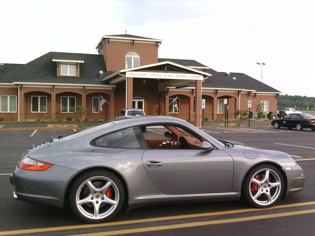

Don't know but I love the color combo on your ride.

kind thank yous

GREAT PHOTO
