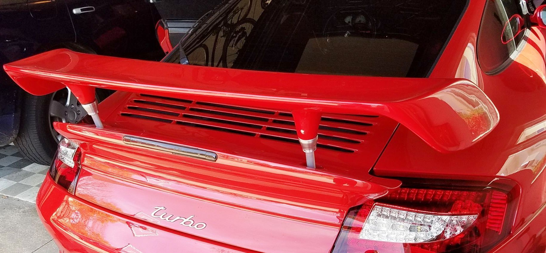

Originally Posted by mark_schnell
PS: Will the electric system work with a Misha wing? I'm contemplating getting one, but not sure how they mesh with existing. I'm not thinking about doing the whole GT2 replica hatch, just the blade, if that's possible.
Yep, it works great with the Misha GT2 Add On wing.

congrats on that purchase..it would presumably work well with a strosek. pretty sure dave's install notes/diy are on his site?
i would've bought his kit long ago but my spoiler operability after rebleeding ( once or twice in the last 7 years ) is still strong like bull lol
it's probably lasted this long because the strosek is lighter than the oem ha. looking at kc's pic. the misha gt2 add on is fairly *aggressive* while the strosek ( or even a techart ) is about halfway more aggressive ( looking ) from oem. leaving completely aside any commentary on the respective aerodynamics of one over the other.
