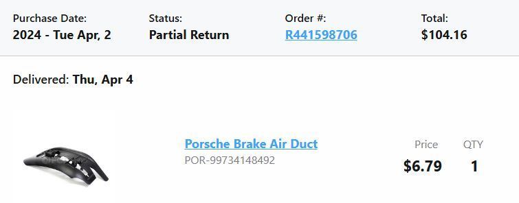

Originally Posted by GC996
Fwiw, what you are looking at are not ceramic rotors. You wont run any cooler. But you may give up braking power which imho I wouldnt sacrifice.
if you are lookingbfor more cooling, get yourself a set of GT3 lower brake ducts. They are cheap and easy and will provide better airflow for brake cooling.
You can also get the GT3 front fender liners which are another great upgrade. Dont waste your time with modifying the 996 front fender liners. You need to seal up the lower air duct in front of the front wheel and remove the rear air duct on the back of the radiators to redirect air flow to get any benefit. Hence just going with the GT3 front fender liners which do this.
However, if you want better braking, then thats another conversation.
Used to be cheap
April 2024 vs today
