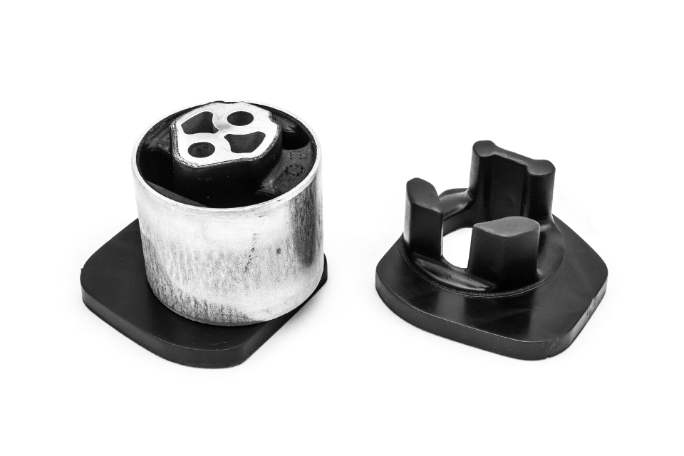

I just wanted to point out that our Transmission Mount Insert is used in tandem with the OEM bushing, so it's a supplement to what's already installed in your car. Aside from the performance and reliability enhancements - the benefit to the additive design is that no permanent change is made to your vehicle (preserving your car's value), and installation is far simplified - especially if you're working on jack stands!
Here's a picture of the TRACK hardness insert with an OEM 996 bushing (similar to 964/993) showing the fitment. That bushing is pressed into the transmission housing on 2WD models, and pressed into a bracket on the AWD models.
And here's an installed Trans Mount Insert from a 991. It just slides into the OEM bushing:
