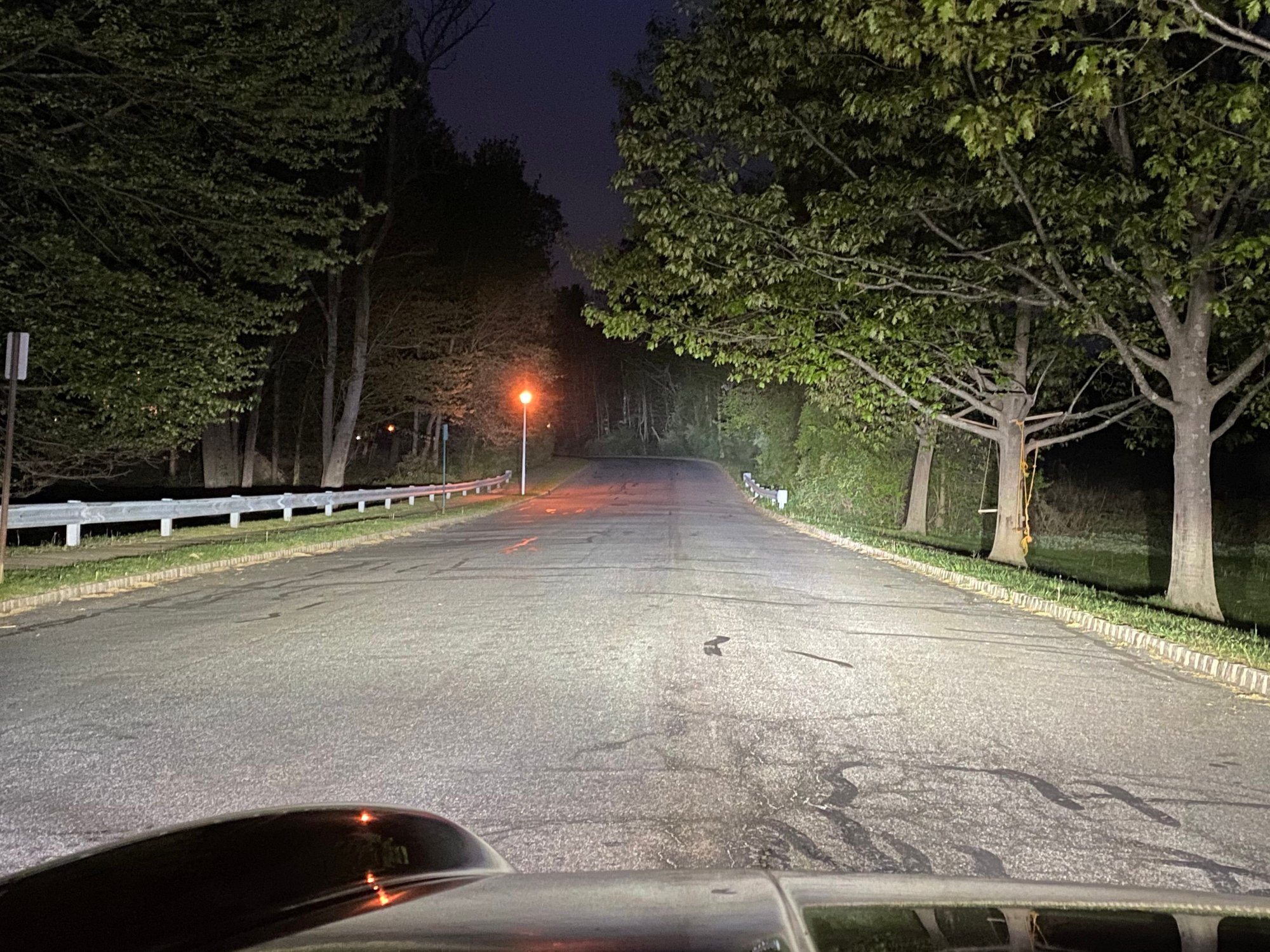

I use Tore’s kit (berhville fx). He posts on this board frequently helping people sort electronics.
I use the low beam HID and the high beam LED bulbs. Replaced all running lights, brake lights etc.
Huge improvement for seeing and being seen. Brake lights are bright enough to almost hurt your eyes from behind the car.
Here’s a photo testing out the LED high beams. You don’t need more light!
