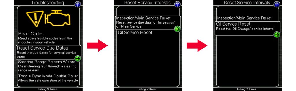

Clean and Simple
To use these functions, simply update your Accessport's firmware and head over to the troubleshooting menu, there you'll find a new option of "Reset Service Due Dates". There, you'll be presented with options for resetting the standard Oil Service interval as well as the more in-depth Inspection/Main Service reset.

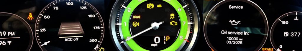

Choosing one of those options allows you to enter in the Date/Month that the service was performed and push out the next vehicle service reminder to the next standard interval of mileage or time for your specific vehicle:
  • If Oil Service Reset is performed, this will set your next service date 1 year and 10,000/12,000 miles (dependent on vehicle) from the date you entered
  • If Inspection Service Reset is performed, this will set your next service date 2 years and 20,000/12,000 miles (dependent on vehicle) from the date you entered
