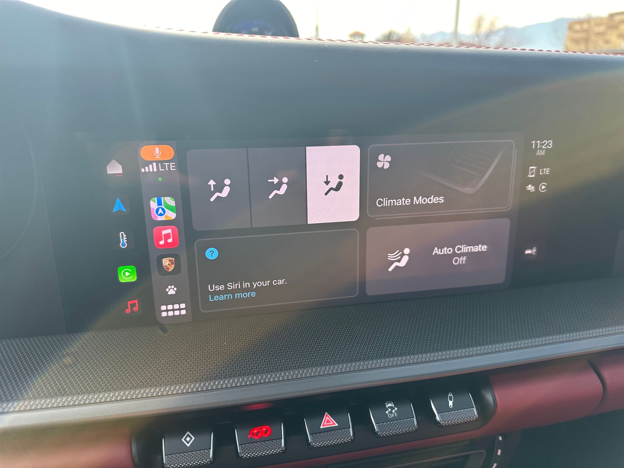

There are 2 aspects to this update:
1. The “My Porsche” app running in CarPlay, which just lets you control a few basic car functions. There are no new capabilities here, just alternate UI.
2. iOS Shortcuts for car functions. This is new. There are two facets of this:
2a. You can ask Siri to trigger these functions, e.g., raise/lower the temperature, tweak ambient lighting, and a few others.
2b. You can use the Shortcuts app on your iPhone to “script” behaviors that integrate with your car. For example, you can write a script that triggers when you say “let’s go home” that starts driving directions home, txts your spouse your eta, turns on the climate control to a warmer temp, sets the ambient lighting, and starts your “chill” music playlist.
I played with it this morning and, unfortunately, they’ve only exposed a small number of functions to iOS Shortcuts. I hope that this is just the beginning and that they will expose many more over time.

Last week took mine in for 2yr service. Dealer updated PCM.
The left hand icons are now colored.
And I have apple carplay Porsche app functions.
