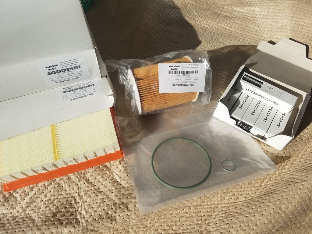

I changed mine on my 2015 last weekend at 18,500 mi as part of the complete 4 year / 40k service. I also debated whether it was necessary but in the end asked myself when has it ever been a good idea to undermine / extend the service intervals recommended by a manufacture? In most cases many of these intervals should be shortened and not lengthened in my opinion ( especially oil).
In any case, the original plugs looked good but were a little tight coming out so I can see the logic on the 4 year 40k interval though I've never experienced nor heard of one completely seized in a head. Besides, changing the plugs gives you or your trusted technician a great opportunity to get up close and personal with your engine. I was able to determine all 6 cylinders are running properly and inspect the ignition coils as well and have zero regrets about changing them. I was also surprised at how dirty the engine air filters were as I do not live in a particularly dusty area in the Northeast.
