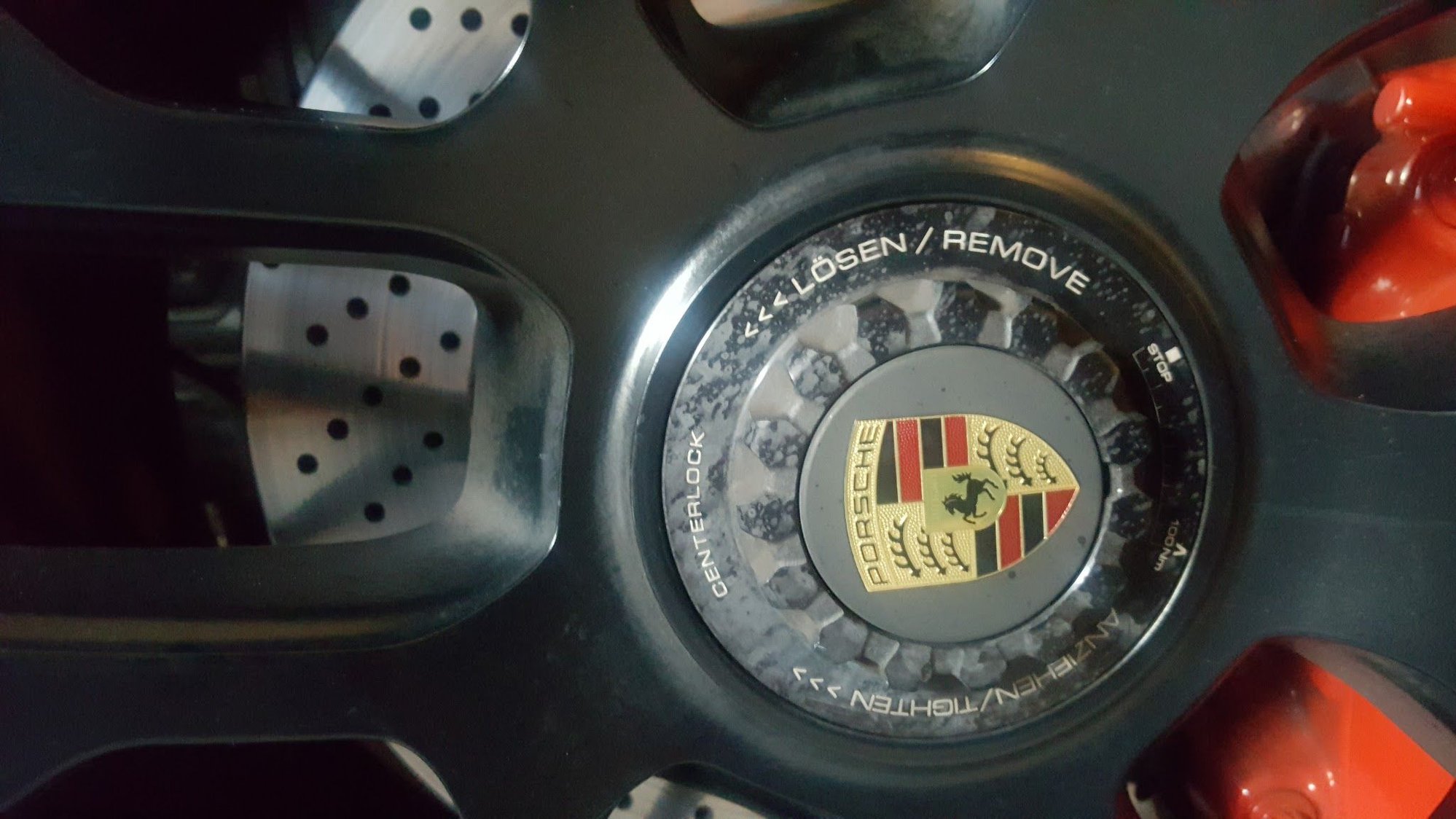

I just noticed this for the first time after having my tires changed at the dealer. Never happened before after 2 years ownership..I admit I let the dealer (for the first time) clean the car because I was lazy and it was winter ..never again. Is this from the torque wrench or a defect in the bolt? I have used 2 different wheel cleaners and never before had this problem.

Don't think its torque wrench as whole nut seems messed up. And it doesn't seem scratched, rather that the finish got chemically damaged. How do the wheels look? Maybe they just scrubbed too hard with a harsh chemical? How do the wheels look? Also do all 4 CLs look the same? Go back to them and have them replace all 4 CL nuts.

The wheels actually looks fine. Yes all 4. I was reading above and apparently the center bolt is anodized aluminum while the wheel is painted, so the bolt is susceptible to this type of damage. I'm going to take it back when they open. Will report back.

Neither. It was from the industrial grade, acidic wheel cleaner the dealer used. Have them replace if they truly didn’t look like that before.

Hello all. My GTS's centre lock nuts have discoloured a weird, mottled white-grey. See picture below. It's very noticeable against the black rims, and distinctly unattractive. I have been enjoying the car on track, and wonder if the wheels getting hot have led to this? However I can't imagine they're meant to discolour like that regardless of track use. Any thoughts?

They are anodized I stripped them down there are 5 separate parts in total and had them anodized properly, they are satin black but you can have a range of colours... you never see a Lamborghini with white centre locks.. I can arrange for yours to be done if you wish cost is around £250 per set, however if the cone collapses due to them being overheated as a result of track use we cannot be held responsible usual turn around is 2 to 3 days plus shipping time. You do lose the white lettering but you can still see the writing in black regards David

Two of mine (post a car wash) had the issue and I rubbed a small amount of olive oil on them (which was a remedy in another thread). Tech at dealer said that was ok. They look like new.
