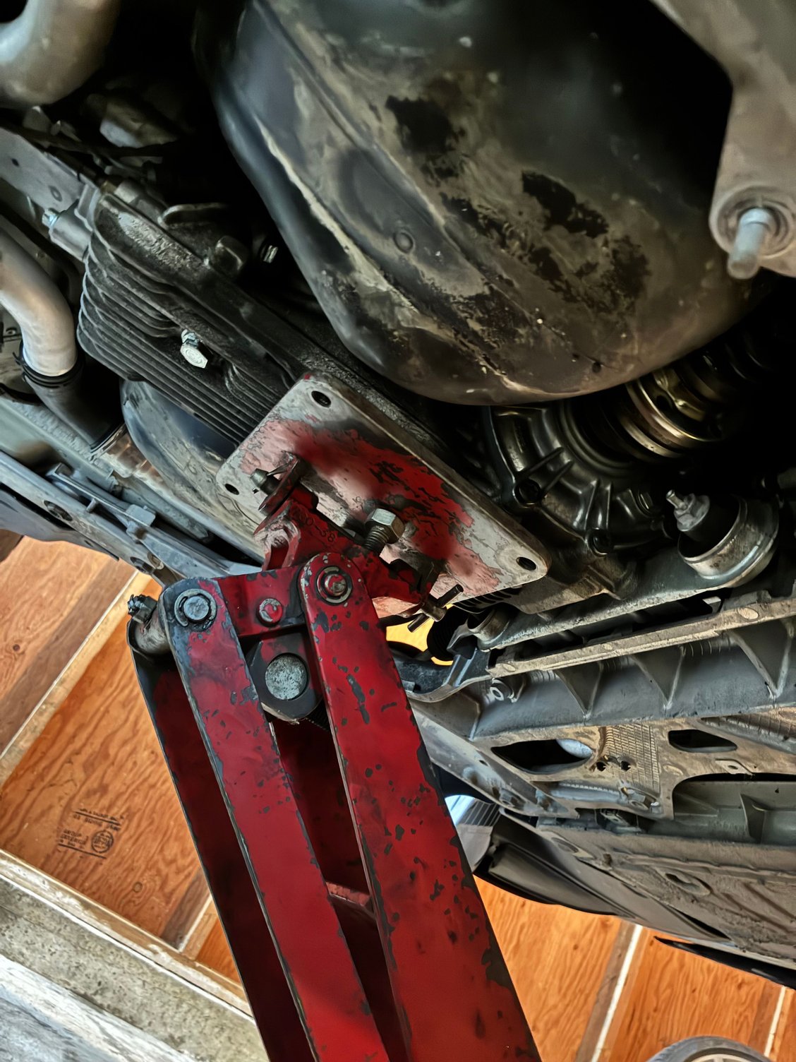

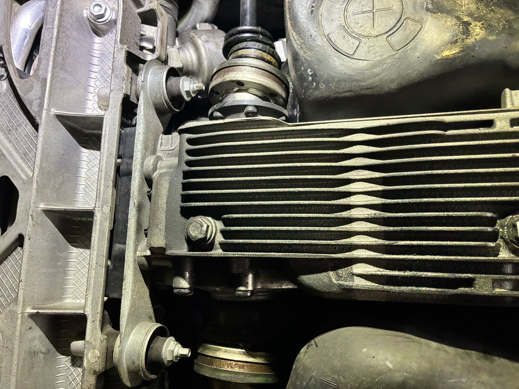

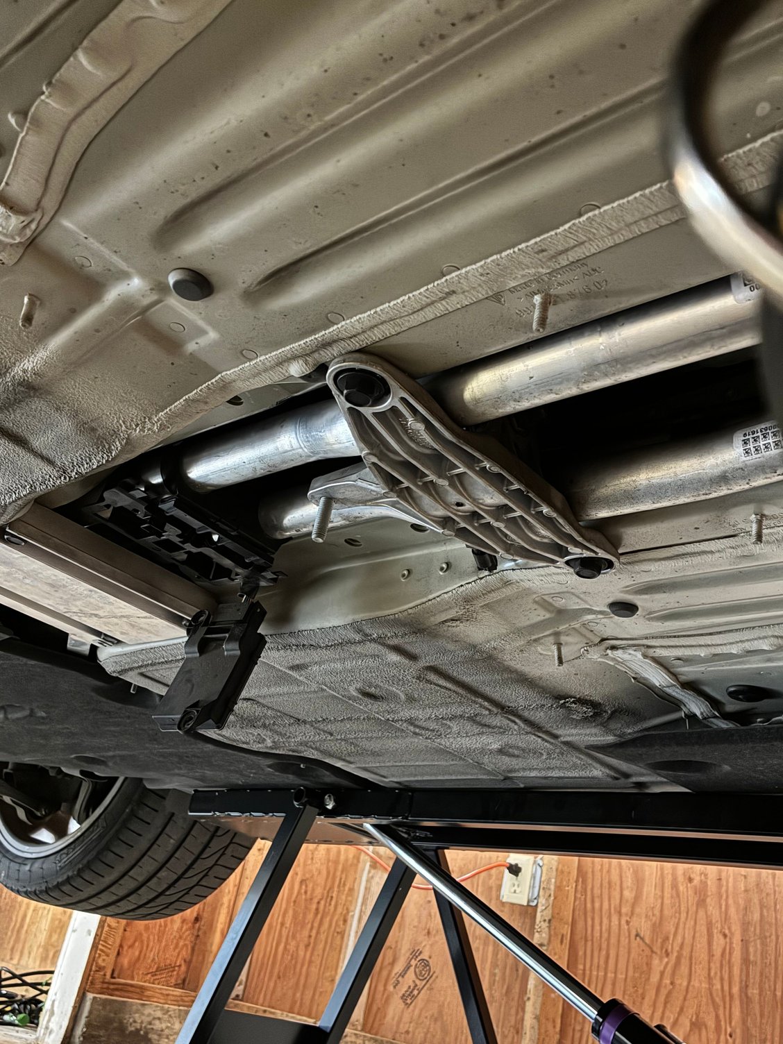

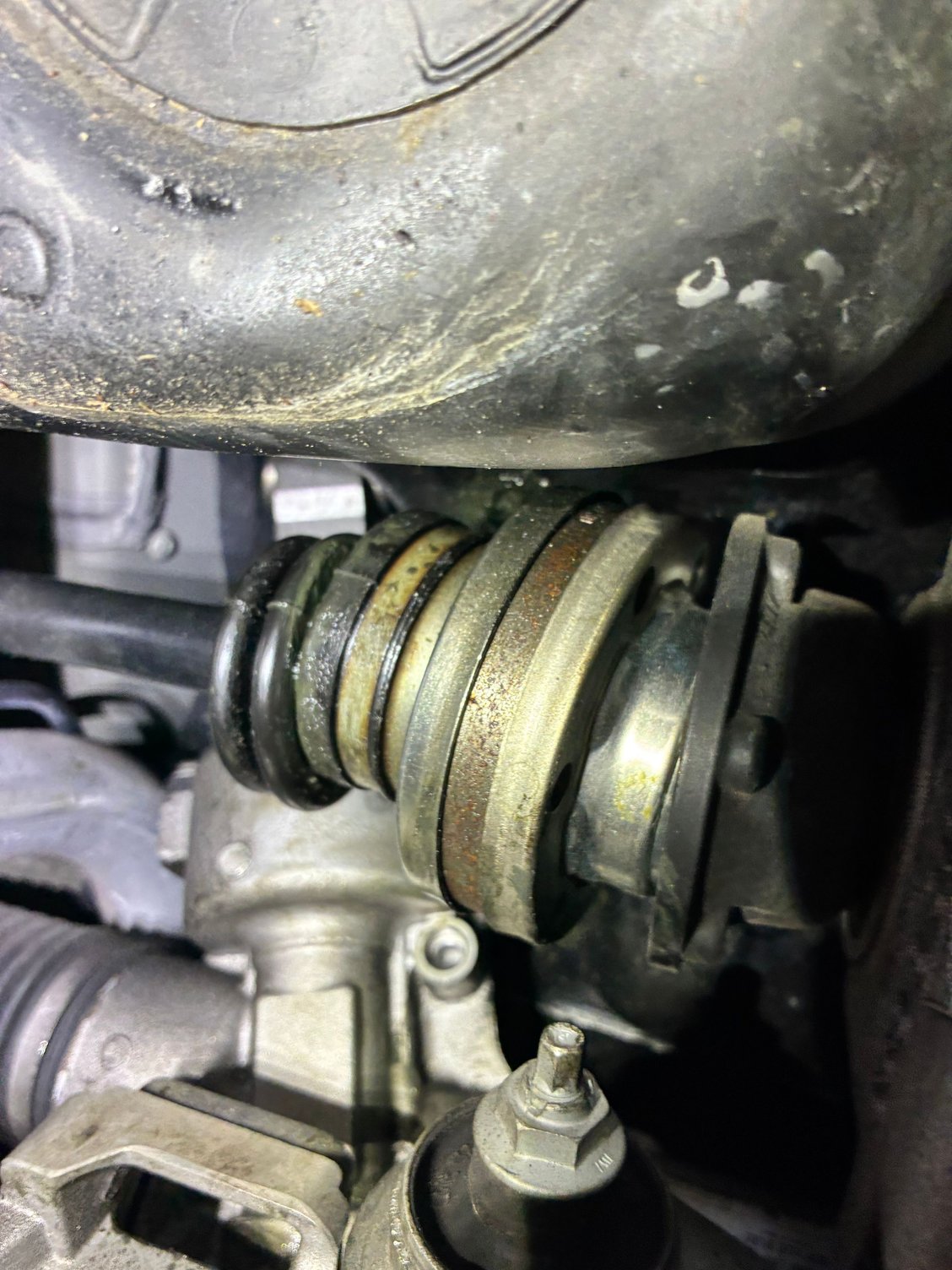

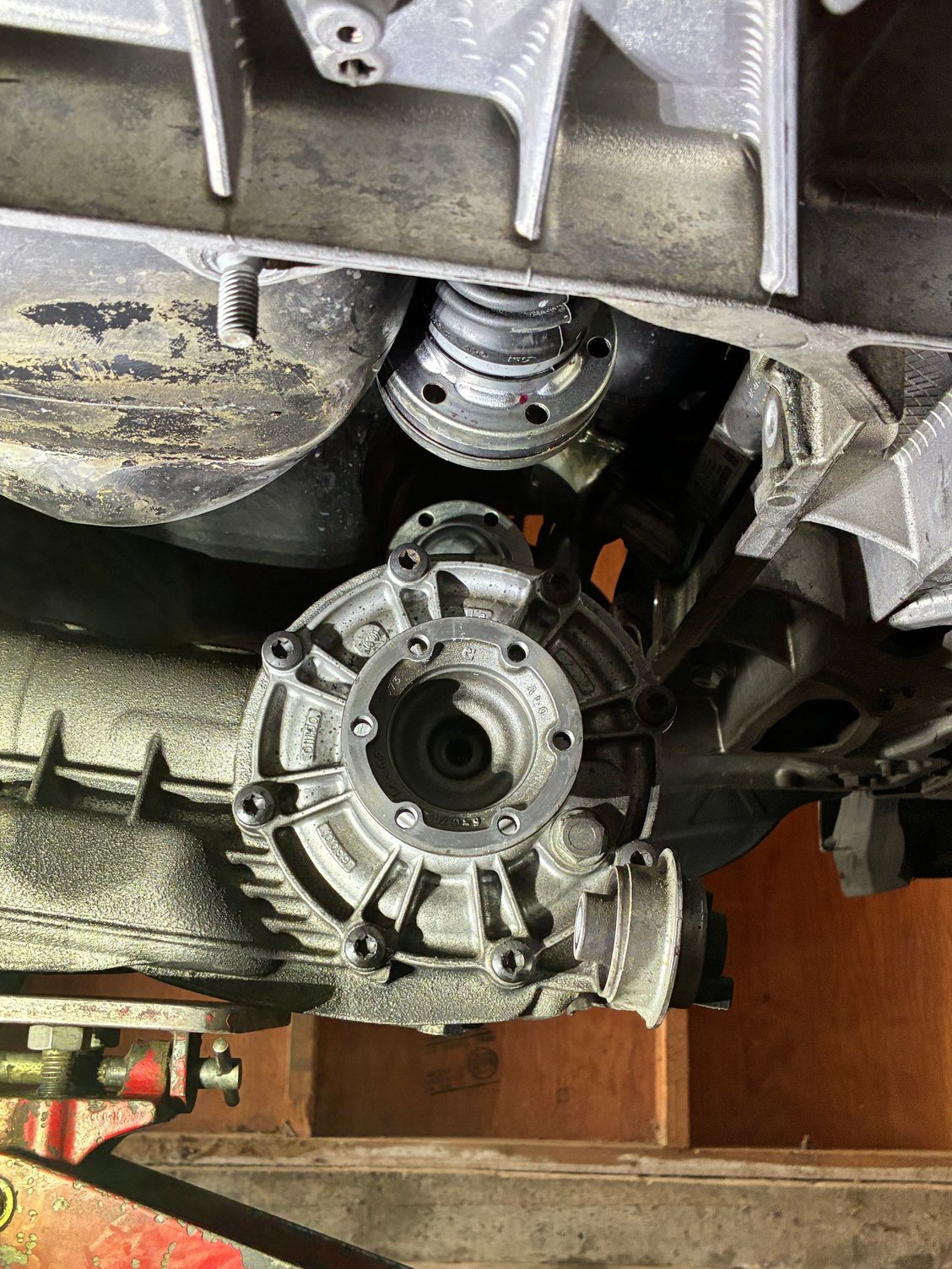

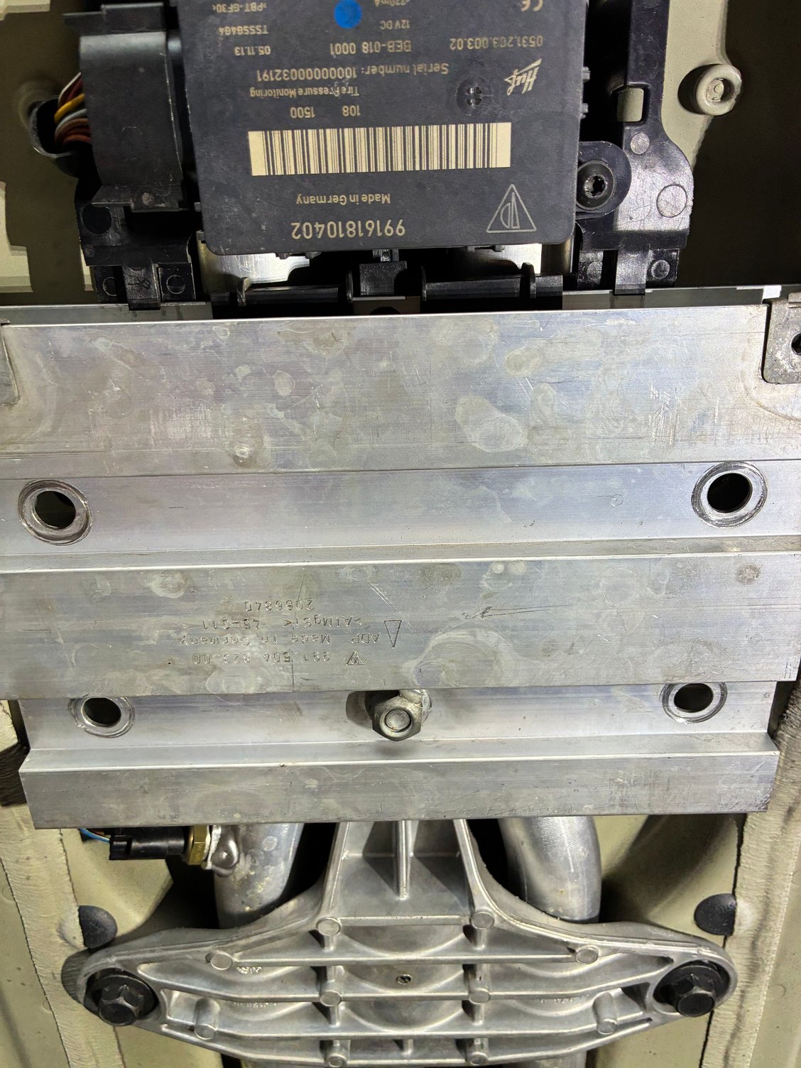

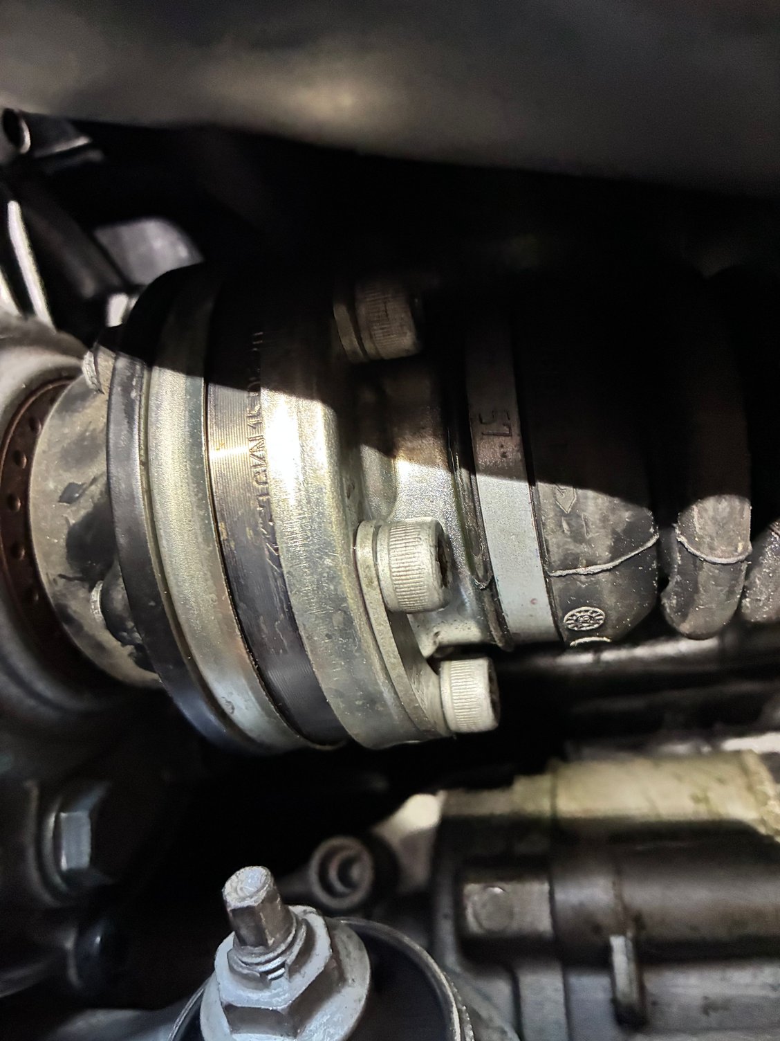

Here’s a couple pics I saved. I just loosened the rear mount if I remember correctly to let it drop without interference. There are some was a plastic box with electrical connection that I took off. Should be minimal from that end. Most of the labor time is at the front once you loosen everything you will need to pry the front mount toward the rear of the vehicle to clear and lower from its current location. Good luck. It will be a good felling when you all done and done.
Prying it back towards the rear
Dropping it a few inches

Amazing, thanks man! So I guess it's just pivoting slightly at the joint of the cardan shaft then. FSM says it can pivot up to 20deg, so that should be more than enough to let the front drop a few inches.
I'm just reading through the FSM procedure for dropping the cardan shaft, and it seems wellbeyond what I'm open to taking on this weekend. So glad you didn't have to do that.

Got it done a 2 weekends ago! Sorry for the late reply, been too busy recently to write it up. It was definitely more than anything I have done before, but doable provided you have the right tools, a copy of the FSM, and plenty of time on your hands. The most nerve-racking part was definitely balancing the front diff on a transmission jack while it was still connected to the cardan shaft. The risk of it slipping and putting huge stress on the shaft knuckle / transmission was the only thing that made it stressful. If I had to do it again, I probably would have just properly gone the for the full front final drive removal (removing the cardan shaft, fully lowering the front final drive, etc.). But it worked out, and I didn't break anything

  5. Remove bracing and plastic electric box from the middle of the underbody (under the rearward part of the final drive)

  8. Remove the front final drive. This is where you can either take it fully out or just do what I did at your own risk:
    1. Support front diff with transmission jack
    2. Loosen rear mount
    3. Unbolt the bolts running through the front mount
    4. Lower the jack only a few inches. Remember, you do not want to be putting too much flex on the cardan shaft joint

bracing and box to remove

Jack under the diff
Jack under the diff
rear diff mount loosened/lowered
Freeing axle from the diff
diff lowered below the axles
