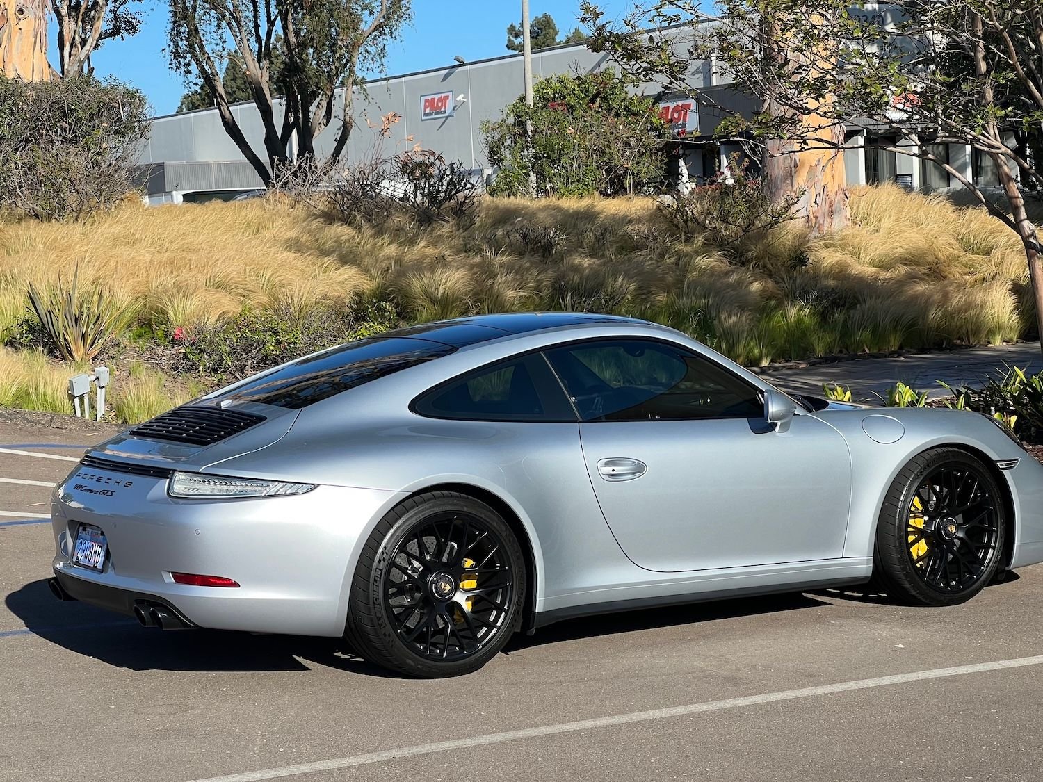

Default 991.1 Headlight fell out!
I have a 2016 Carrera GTS. I bought it 2 years ago with 15K miles. It is a really great car, I love it. It now has 20k miles. I've had only one problem, and that was a broken spoiler lifter. This is apparently a common 991.1 problem, but my genius mechanic, Adam Gill, fixed it.
The point of this post is that yesterday, as I pulled into my driveway, the proximal object warning went crazy, and when I got out, the driver's headlight was hanging out by the wire connector. WTF? I put it back in using the headlight tool, and looks fine, but it won't give a final click to completely seat it. It will definitely come out again.
So, I tried to take the passenger light out to see when a functioning headlight looks like, and for the life of me, I couldn't get the tool to latch onto a nut.
I know I'm not a great mechanic, but this seems weird.
Anyone know anything about this?
This is the culprit
This is the culprit
