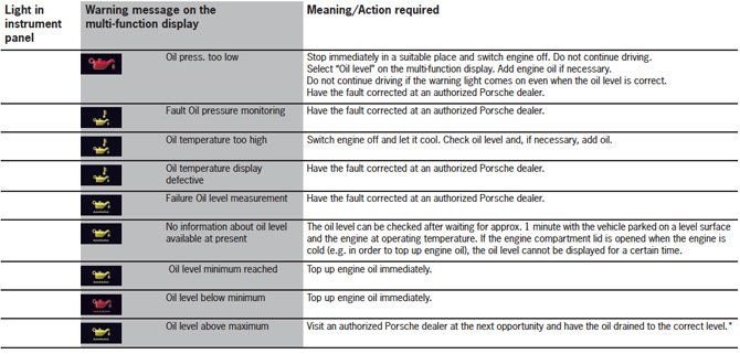

To seek some clarity on this, even though it doesn’t apply to me currently (but good to know, regardless):
Does anyone know for sure whether the car will warn you when you are getting NEAR a level of needing a refill (i.e well out of a danger zone, but warning that you may be entering it) (and now I have Kenny Logins in my head), or if it warns you, does that mean that you are ALREADY in a danger zone.
There are two warnings thrown - one is yellow when oil levels are at minimum and another which is red when oil level is below minimum
Porsche_nuts is online now
Thanks! I got mixed messages from what I read in my manual. But it was late and I may have understood incorrectly.
