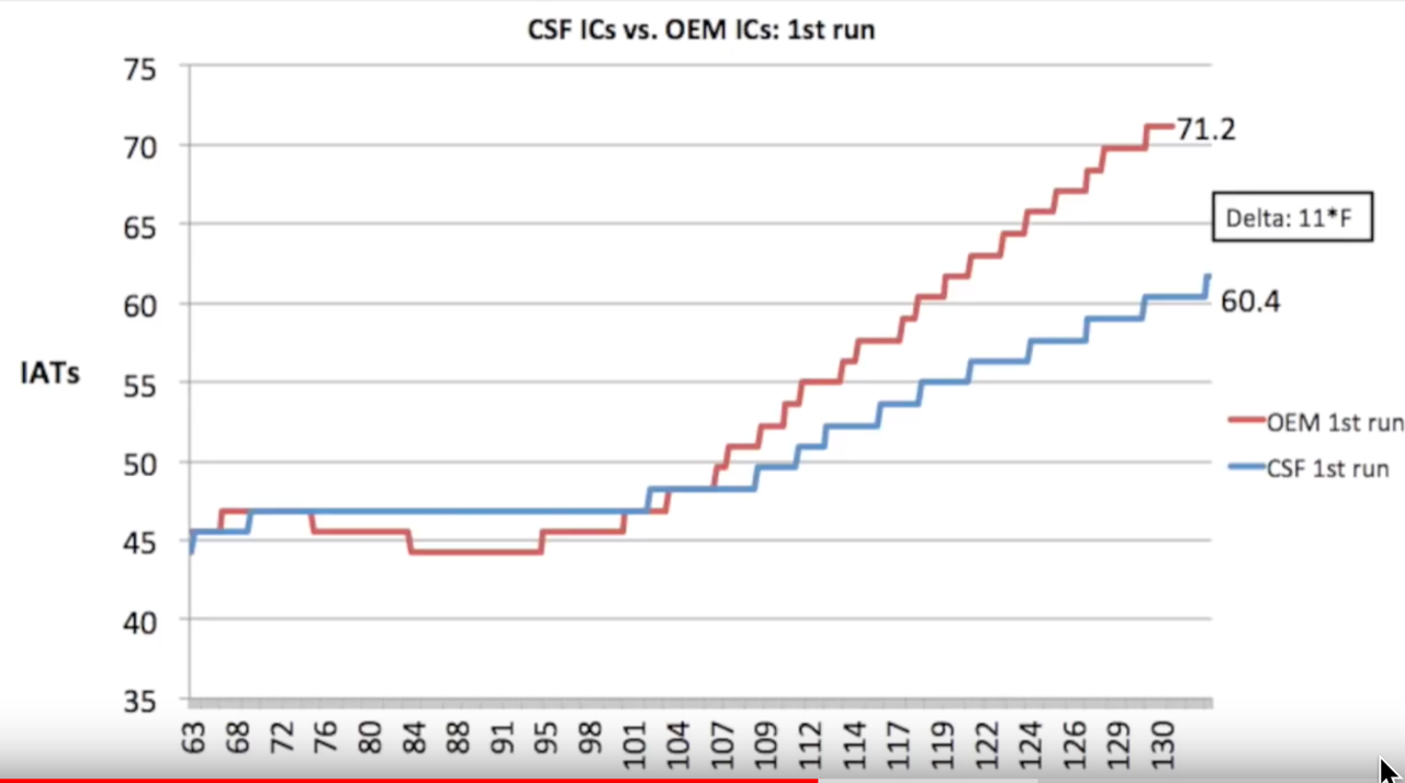

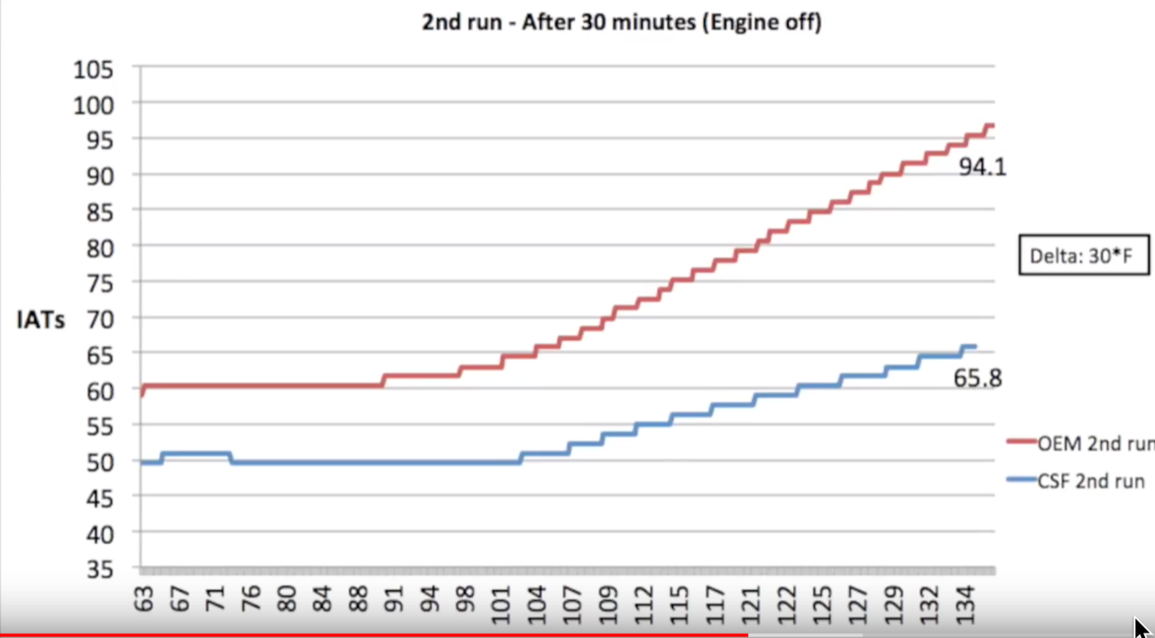

Watched your vids. Great job. I’ve tested a lot of IC’s over the years on other platforms. ATA and ATW. Your first comparison looked “reasonable “. The second comparison with different starting base temps that showed a ~30F delta is odd. The starting temps should be equal. Overall, great job.
Thanks man. Make sure to look at the “description” under the video. I explained a lot. You’ll see that the data is pretty reliable minus a silly math mistake I made.

Read that, no biggie. Only thing is you can’t start a test of one at 50F and another at 60F. That delta kills the data. Overall, killer job ! Looking forward to updates !
Not sure where you are getting your numbers from. All tests were done in very similar ambient temps as stated in the video. You’ve lost me, lol.

Numbers are from your charts in the vid. I'll post them below to show the difference in IAT's at the start. Not an ambient issue, but a thermo transfer issue. I'm sure your test ambient conditions were close. Keep in mind an ATA IC is arguably a heat sink first and a heat exchanger second due to the inefficientcy of ATA. You first test was very reasonable. Both IC's started at a sink temp of roughly 46F. That is built in thermal energy when you are transferring BTU. You can reasonably measure the benefit of the better IC assuming Boost Pressure, load, ambient, etc. etc. were the same.So a very "reasonable test.
The second test is where the train left the tracks. The new IC started at 50F and the OEM IC started at 60F. Can't compare heat sinks that way. The stored energy will be much better in the 50F, plus the 50F IC has much more mass (heavier) to store even more energy than the OEM IC since the OEM is starting at 60F. You can even see it in the OEM IAT slope.
No biggie....just curious observations.
