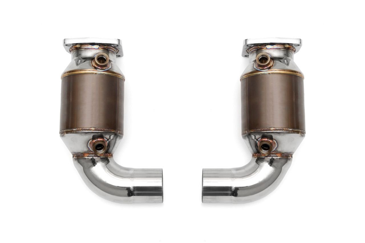

200 cell cats and you'll never have a problem, tune or no tune...I ran cat-less with GIAC and always had a CEL on my 991.1 and that sucked. Hate lights. the fabspeed 02 sensors with mini cats could very well work for you...otherwise, just run a set of 200 cel cats and don't look back or have to mess with any more tuning.

Yes, sechsgang is correct. We sell a 200 cell sport cat that is 93-95% free flowing, giving increased performance, increased exhaust note, and GUARANTEES no check engine light. Take a peek at the product and feel to reach out for forum pricing!

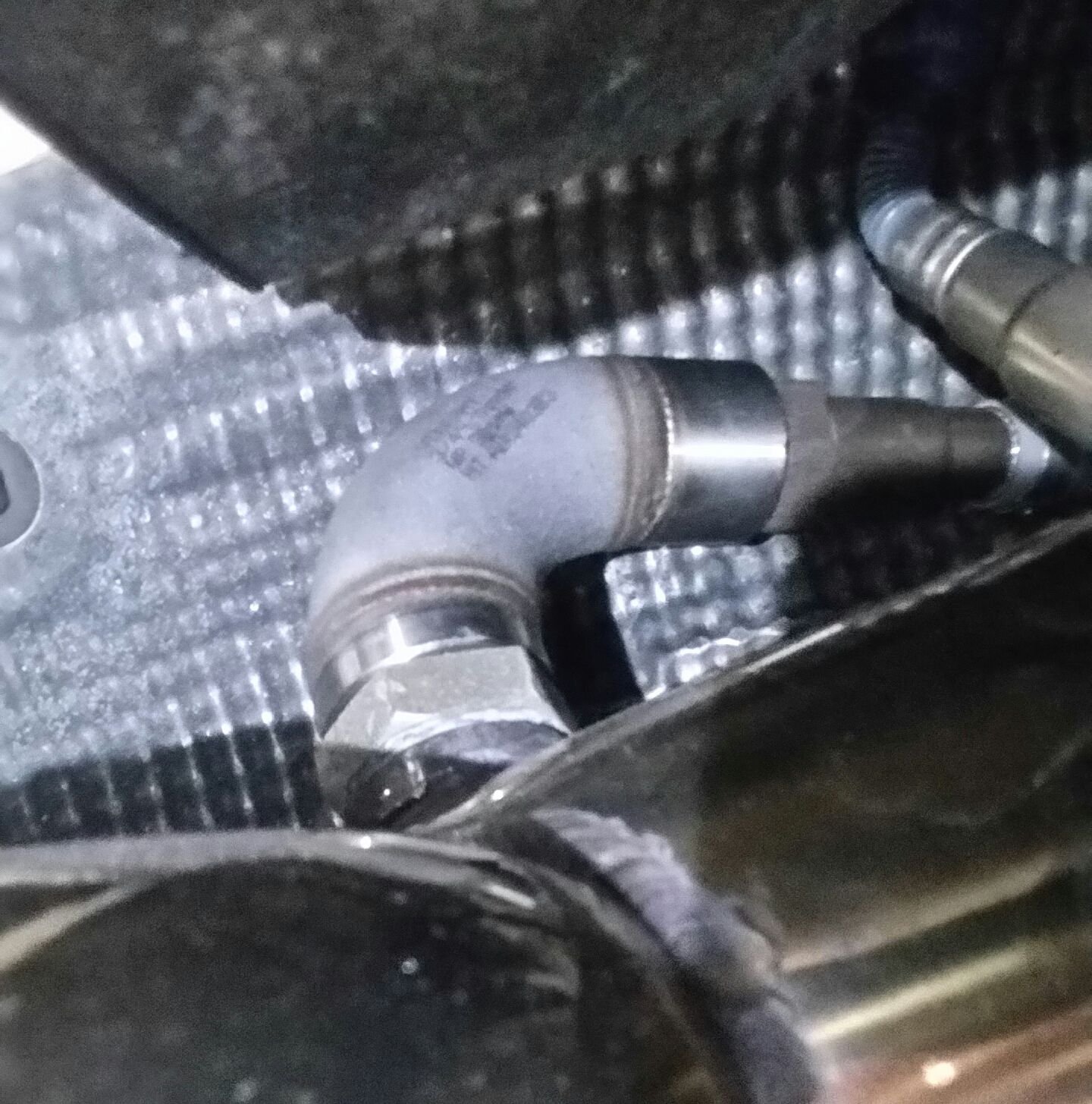

Iím running Kline Catless with the smallest spacers Sam provides and randomly get a cel light. Usually only happens when I donít drive the car for a few weeks. Do you daily drive it and still get the cel?

I'm running Kline Catless with Kline headers and I use the Vibrant spacers with the smallest diameter plug installed and I rarely get CEL. It has happened in the past, but not since I installed the headers. When it has happened, clearing the code usually works for several months. Make sure the smallest diameter (hole) plug is installed in the spacers.
Yes, I have the vibrant spacers with the smallest inserts and still get the CEL.
TeesTurboS what headers do you have?
