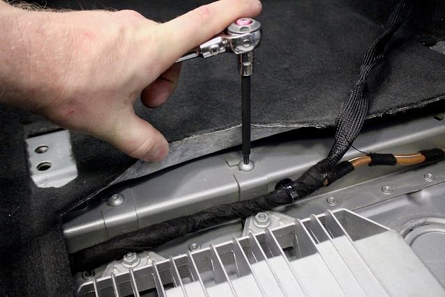

I also just realized I never updated this thread with install photos – Here they are:
Step One // Doors
The doors on the 991 are where our new 4" midrange and 9" woofer are going. We start by removing the door panel itself, which is a relatively straight-forward process on these cars. There are (4)T30 Torx bolts that come out and the entire door simply lifts up and off the mounts. There are 2-3 wiring harness that do need to be disconnected depending on the car's options.
Once we have the door off, we want to add the acoustic treatment to the door cavity as well as the door panel we removed. The kit will actually come with pre-cut sections of SoundSkins that are designed to fit certain areas for the best results. After that's done, the speakers can be installed. Both the midrange and Woofers are bolt-in using the original Porsche hardware. The midrange speaker is a direct plug-in to the factory wiring, and the woofer requires a hard connection. Soldering is best, but non-invasive taps can be used with the pigtail we provide.
Step Two // Tweeters
Then on to the tweeters, which are a fairly simple install. We remove the factory grilles and the new tweeters come with hardware designed to fit the Porsche perfectly. We also include a new set of wires that run directly to the tweeters so that they have their own discreet amplifier channel. A wire-guide is included and the Porsche interior makes this an effortless task.
Step Three // Amplifier
Last, but certainly not least, is the new DSP Amplifier. The factory amplifier is located under the passenger seat. Removing the seat is as easy as four bolts and two wire harness disconnections. We take the seat all the way out of the car, but if you're not up for that task, it can simply be rocked back and a prop set underneath the feet to hold it up. The original amplifier is held in with three small brackets that bolt to the body of the car. This is where our new amp mounts bolts up so it's just as secure as the original.
The wiring for the amplifier is also relatively simple. There is a factory grounding lug in the amp well under the seat that we use for the new amp's ground, and all of the speaker connections (minus the tweeters) are a direct plug and play with the original amp harness using the new adapter we provide. The only other cable that needs to be run is the main amplifier power. Luckily Porsche gave us a great power point to access below the carpet in the passenger footwell below the glove box. Our new power cable is easy to route forward and connect to a junction point here.
Step Four // Enjoy
..... and that's it – ready to enjoy audible bliss! The DSP is pre-tuned specifically for the 991, so there's no adjustment involved and the setup is already optimized for the environment it's in! The whole install process took us about 6-8 hours, and we were documenting the process to compile a thorough install manual. Without that, we could have knocked it out in about 4-6 hours. Be sure to shoot me an email if you have any questions about the setup!
