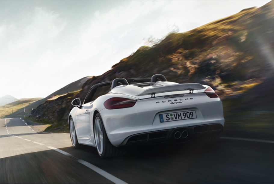

I'm trying to understand what some Spyder owners have already noted: The rear wing's "service" height (when pressing the button on the dash) only raises it about 1" (much shorter than standard Boxster), but at speed, it fully raises to the expected 4". So that implies that there are 3 positions in total (Closed, Intermediate, and Fully Raised). Here are examples of the 2 raised modes:
But what are the operating ranges or speed thresholds for each mode? Does the Spyder wing raise to the intermediate height at at 75 MPH, then fully extend to the 4" height at even faster speeds? What I didn't expect to learn (see
) was once it deploys while driving, the rear wing seems to only vary between the 1" and 4" height (or is that only in a narrow speed range?). When does it go back to the fully lowered/closed position? Below 55 MPH? Or only at rest?
And why does the Spyder need an intermediate height when the regular Boxster gets away with just 2 modes?

If you hold the button for extended time (approx 30 seconds) the spoiler goes down and back up to the full extension. Not really sure why they do the lower height mode when manually lifting.

The manual says "Automatic mode
Depending on the vehicle speed the rear wing extends automatically at speeds above approx. 75 mph (120 km/h) and retracts again below approx. 50 mph (80 km/h)."

Note that the lower height is only used when pushing the button. When in auto mode, it's fully extended when you hit the 75mph as posted by il pirata

I'm not sure that is correct. Because the "lower position" (which I refer to as the "intermediate" or middle position) is clearly being utilized many times in this video:
(Unless this is only happening because the Spyder owner pressed the button on the dash so it never goes to fully closed position?) According to the video, the Spyder doesn't seem to alternate between the fully extended 4" and fully closed like regular Boxsters. It appears to only bounce between the full 4" and 1" intermediate position. Why? And at which speeds does it do this?
Or is that only coincidental due to the speeds of the car in the video? In other words, will a Spyder wing alternate between fully closed and just the 1" intermediate height at slower speeds (say 55 MPH to 74 MPH, but once over 75 MPH the 4" height is used)?
I guess what I'm trying to determine is what the speed bands or thresholds are for each mode or height. Is it something like this?
  • Fully Closed Until 55 MPH
  • Intermediate 1" Height Between 55 MPH and 74 MPH
  • Full 4" Height at 75 MPH+
