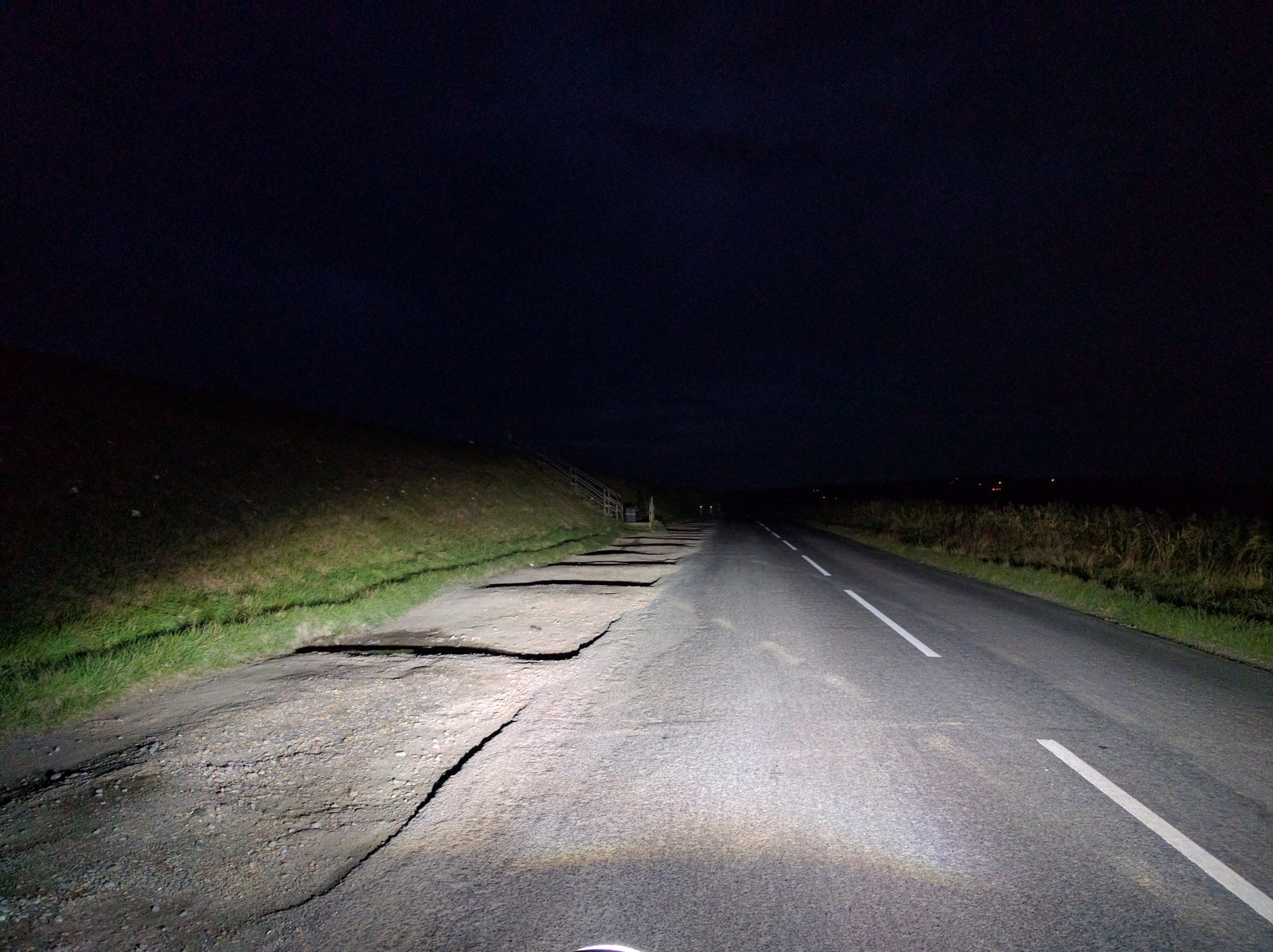

Originally Posted by C4inLA View Post
Would like to see a pic(s) in use at night.... Car looks good...
This is low and high beam at night with Franšois' product. Not much visible difference as it is a long straight road with no obstructions. But I can tell you the difference with stock is remarkable on a real life night drive.
