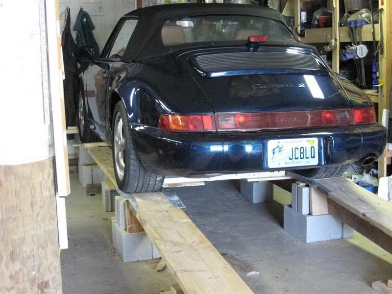

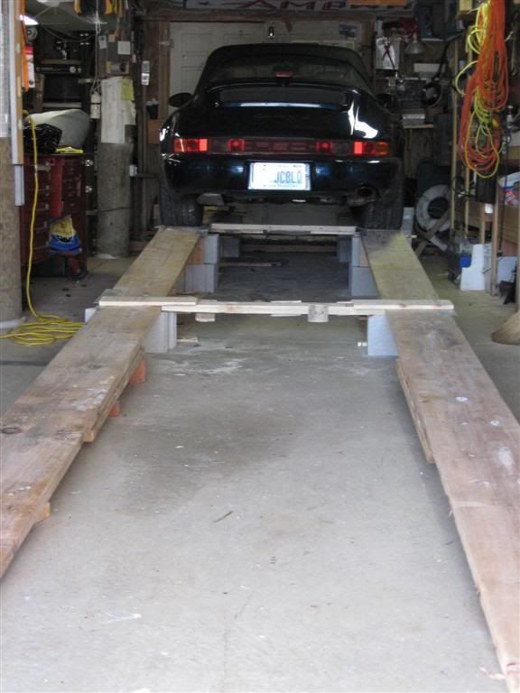

Here's the part I forgot to mention I needed to do also... I ended up just disconecting battery as I will be home for a week at Christmas and prefer my own wheels... With my luck, we'll have our first white Christmas in a long, long, long time!
I live on the bay in NJ and sometimes it floods into the garage, most I've ever had was 8" tho... I'll have to think up some project to do to it while it's up there!

To cool .

Nice looking ramp ......Top idea .... in fact you got me thinking about having some steel ones made ..... just a thought whats the compression strength of those concrete blocks???? you would be better (safer !) with wooden blocks

"compression strength of those concrete blocks"
They build very large buildings out of those blocks .
The first row atop the slab must be holding up a great deal of weight .

I believe everything has been covered. I would add to put an open tray of charcoal in the car to absorb any moisture, crack the windows about an inch as suggested, and hook the battery to a trickler, make sure the front hood is open about an inch for ventilation for the battery while charging. Just make sure the metal piece that controls the front hood light is adjusted to allow the light to stay off when the hood is up about an inch. I would put a carpet or viscoune down over the concrete to protect the bottom from moisture. But that may not be necessary since the car is a foot over the concrete and should get enough ventilation.

Last toy, never heard of the charcoal idea before... Will need to do some research on that one... If I have a fear about this whole thing, it would be mice... So far I have only seen evidence of them in my garage one time, the occasional flooding the island gets helps keep them in check... I thought about laying a tarp over the ramp and wrap it up around the car after the cover was on, but decided against it.

Awesome Ramp!!!
