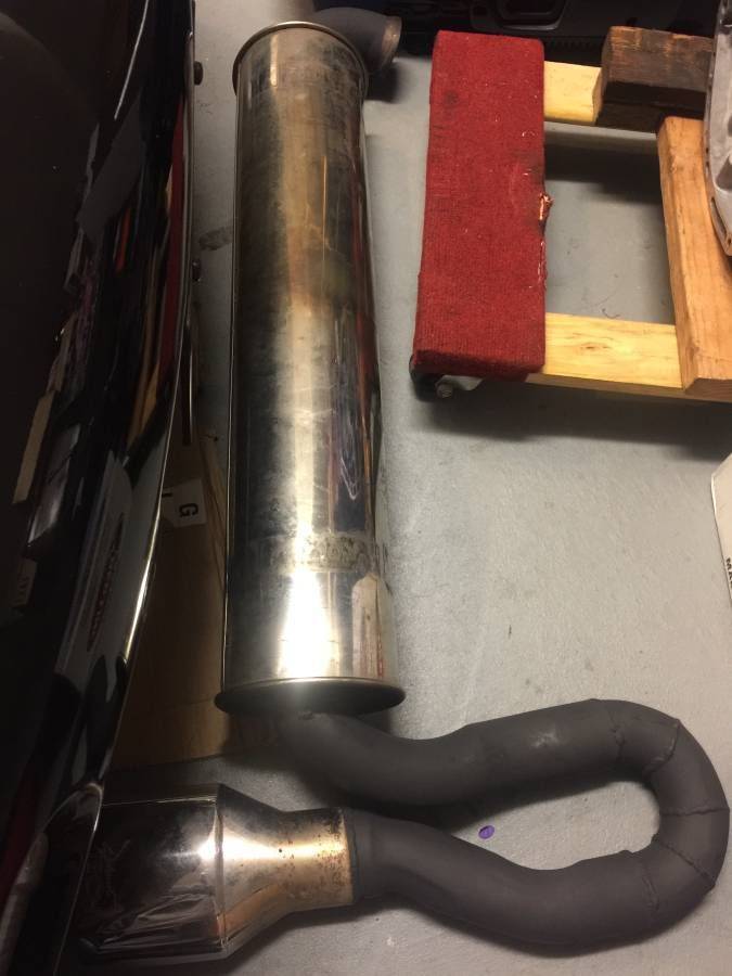

owner is claiming this is a CUP Exhaust. I'm trying to figure out if I want to spend 200 bucks on it to replace stock.
please help
any ideas??? let me know please.

It likely to be very loud! Depends on if there i sany packaging in the main tube to quieten it
Similar to a cup pipe replacing the primary and a long g pipe replacing the secondary, but put together as a single unit

Looks home made or shop built. Note number of welds vs smooth bends. First comment is correct - replaces primary with smaller unit , an secondary is completely removed from system. Will be loud based on packing in primary. Can’t tell if Cat is on on/or used. For what is seen $200 is not bad price as you will pay more for cleaner, better set up

Cup “style” exhaust, but as Gus notes this appears to be a Midasized homestyle version. Similar to Borla exhaust.

It's just a small primary resonator with a fabbed Secondary delete, custom by the looks of it. What does the logo on the tip say?

That is not a Cup exhaust.....

That's kind of a funny exhaust for a street car. It's going to be brutal in the cabin...assuming that long section is not a muffler...or one that muffles...
But if you hate passengers...go ahead...cuz literally no one will want to be inside the car with you...lol. Anyway- without passengers, the car is much faster.

i can always have passengers wear ear muffs!!! He says it says Dynomax. Any thoughts? I don't think the primary is hollow but a dynomax exhaust from??? When and where I have no idea. I read a few things about them from posts in the past but nothing definitive.

I have never seen that one before. But in all likelihood you will just replace it if you're buying the car.
FWIW - all things being equal and without other changes- the oem exhaust performs best. So keep in mind that cup pipes or g pipes are, in effect, just a sound change.

Dynomax is the muffler manufacturer they didn't make this exhaust, it's definitely custom made. Not worth $200 IMO - I would be especially scared of it without hearing it.
