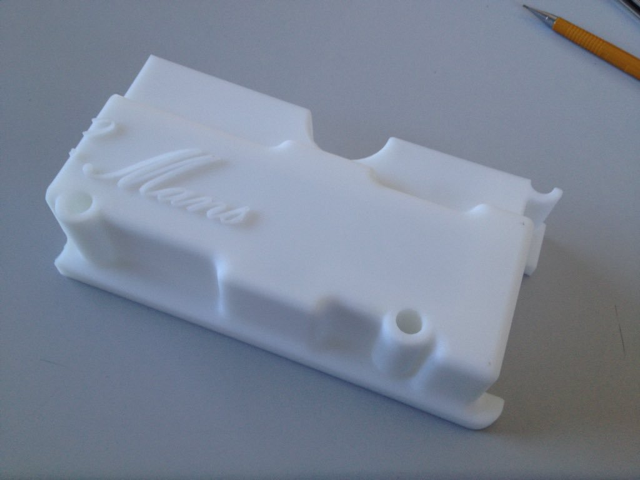

Rom, I only just noticed the cam cover. So you went back to a factory unit?

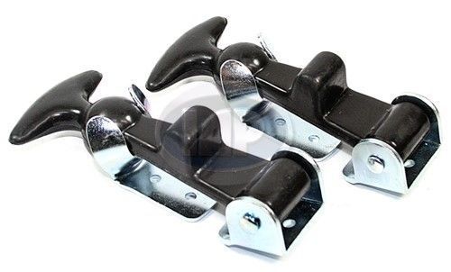

Might you have a pic of the hatch hold down brackets (hatch side)? I'd love to see what you or the factory used, and how you are able to run the hatch down nice and sealed (I have struggled with my own fabricated ones and am having clearance issues. Breathtaking build!
Yes you're right this is one of the improvements we still have to do. I've got the 3D model and done a master to do the casting but it was with a small 3D printing machine (So many pieces like the one in picture) and the result is not as nice as i expected (deformations). I need to find a subcontractor able to realize the part in only one step and not in several pieces i have to weld but the hardest is to find it for a "reasonable price". Price for this type of work is really high (over 2500€ without the casting) so, for the first tests we prefered run the car in security with the Factory came cover . Potential Oil leaking and hot Turbo together are not doing good things
Noahs, i'm not completely sure about what you want to see but if you speak about the rear brackets, these are totally std parts you can find on ebay. One thing we learned during the construction is that PORSCHE used really often parts from their other road models or from the std Automotive industry.

Rom, thank you. So how did you attach those to the hatch? Does your hatch have the standard 924/944 cast aluminum bosses for the pins like the road going cars? Did you weld brackets or perhaps you attach the latches directly to the rubber spoiler?
our hatch is in fiber glass so no problem to fix them directly with screws and bolts
Ahh! this explains EVERYTHING! I never thought about this aspect. THANK YOU for answering my question. … And I love the work of art that you created. Bravo!
