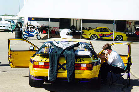

RIDICULOUS? Paul give us a photo of the rear end (the car's not yours). Most of us are trying to squeeze bigger wheels & tires in, not smaller. If it looks anything like the Lindsey's car, I think that's great!:
Anyway, if you don't like Viper-sized 335mm tires, a 315mm would work on 12" rim just fine (Viper came with 13" rim). BTW, a locked-diff and 20psi tires hook up great!

I didn't have a digital pic of the rear end, but it is the same as the Lindsey Racing cars (GT Racing widebody) with 12inch wide rear wheels.
