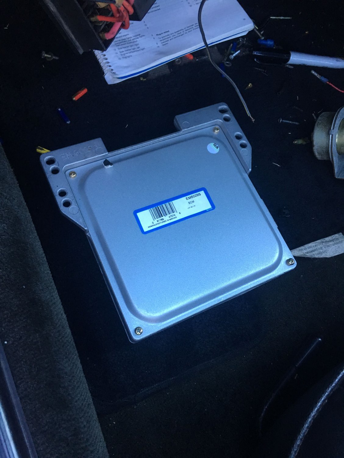

The reason I can’t plug in the new DME is because this is the current state of my wiring harness. The wires attached to the crank/ speed sensors were so corroded and frayed I needed to address this. There’s nothing to plug the sensors into or the DME into. I am still waiting on the new harness.
Just as Dan said, I’ll install the new harness, plug in the DME and see what happens. If the car starts with the old DME then the crank sensors/ wiring to the crank sensors were the issue. If the car doesn’t start then that eliminates the the crank sensors and wiring. Because it’s brand new.
At that point if the car doesn’t start with the old DME I will switch it for the new DME. If the car starts with a new DME then the old DME was the issue the whole time. If the car doesn’t start with the new DME that eliminates the DME from being the culprit and it’s on to whatever else causes mixture issues.
