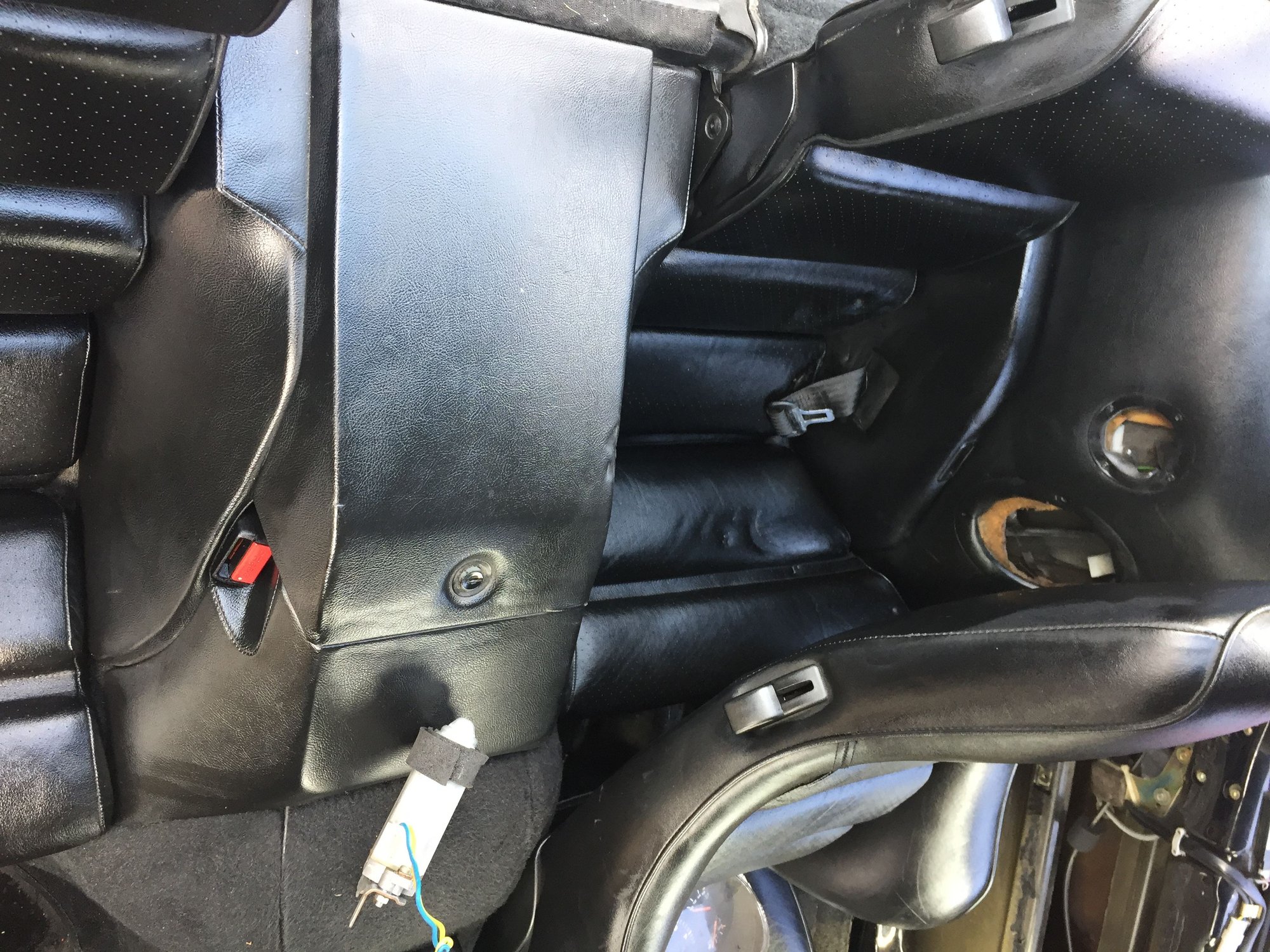

The PO cut so many wires. he should be shot and or castrated. The seats came up good. I installed the door cards in hopes of straightening them out.
