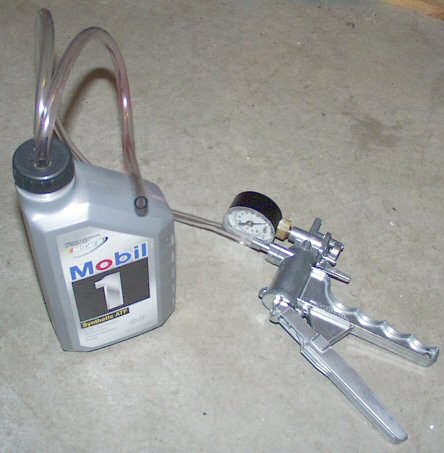

FWIW, my el-cheapo solution (since I already had a Mitivac):
(See the thread on this topic from more than two years ago)
Sorry but I don't understand this. I've got a Mity-Vac but can it blow as well as suck?
Old 07-01-2008, 04:12 PM
Ed Scherer
Ed Scherer's Avatar
Join Date: Jul 2001
Location: Shawnee, KS, USA
Posts: 7,330
Received 108 Likes on 62 Posts
Yeah, there's a "blow port" on there, too (at least on mine). The air has to go somewhere, right?
IIRC, it was late at night when I was doing a tranny filter / fluid change and this was the easy way out rather than waiting until the next day and getting a proper hand pump.
Works just great. In fact, I've still got that empty ATF bottle (actually, just need the cap and hoses) out in the garage for next time.
