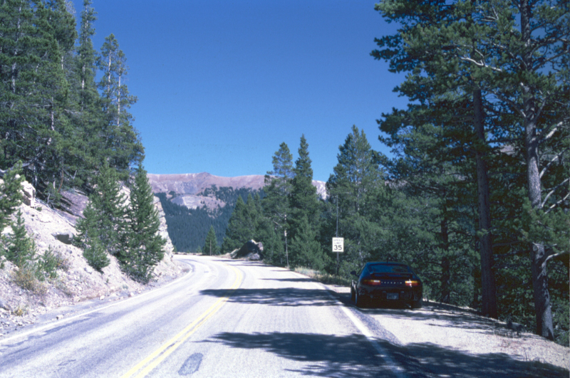

A couple of weeks ago, I was driving the twisties in and around Estes Park, Colorado (see post #58 in "Best Roads In America for the 928" thread for general comments on that great trip).
Anyway, my throttle stuck three times (including once with my wife in the car) while driving these twisties. Rather high pucker factor. Especially the last time, which was at WOT after having reentered the road (from a turnout; stopped to take some photos) in front of some traffic.
It's remarkably hard to haul the car back down to a stop when you can only leave the road at the next available turnout (which aren't very closely spaced). Didn't want to cut the engine too early, either, since I didn't want to get caught going uphill with nowhere to pull off. So... the torque converter got quite a beating.

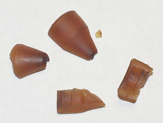

I'm about 99% sure I finally figured out what was going on the third time it happened (the other two times, it "fixed itself" shortly after stopping). The third time, however, when I popped the hood and took a look, I found the socket at the end of the throttle body cable at a strange angle. It was stuck at that position (see animated photo below); a little pressure, though, popped it down into the proper position again and I was good to go. Luckily, the previous day, I had the foresight to put a small container of oil in the car. Lubricated this ball/socket and it has been fine ever since.
But... this episode had me thinking about doing some preventive maintenance on these cables, guides, and the ball and socket connections. Some questions for those of you that might have had similar problems (or might have some of problems similar to what I'm about to describe):
  1. Has anyone else experienced a stuck throttle like this? Did it take anything beyond just lubricating the ball/socket connections? Any preferred lube?
  2. Note that the little rubbery, amber-colored, conically-shaped guide that used to be on my accelerator pedal cable split into a few pieces and eventually fell off (see the second photo below for the remains). Is this an individually replaceable part? (Hard to see how you could replace it unless it's really stretchy, unless you recrimp the end of the cable). Is this an important part? Is there much of a risk of increased wear (or sticking cable or something) if I don't replace it?
  3. Note that the black plastic, conically-shaped guide that used to be on my A/T kickdown cable is also broken off (you can still see a little fragment of the remains, though). Is this an individually replaceable part? (Again, hard to see how you could replace it without recrimping the end of the cable). Important part, or not? Risky to run without it, or not?
  4. Generally, what is the condition of these guides on your car? The remaining guides on my car look like they're not going to last much longer. Starting to split and disintegrate.
The guide (or whatever it's called) that broke up and came off the accelerator cable end:
One of the "surprise stops". Couldn't just stop anywhere (lots of blind corners, so not wise to stop in street, but no shoulder either). Couldn't just shut down engine, either, because I was going uphill. So, had to time a pull-off, shutdown just right.

Had it happen to me on a busy main street. Stupid me, I had blipped the throttle to give bystanders some engine music. The engine got stuck in WOT, so I literally shoved the brakes to the floor and pulled over as soon as possible, which was a few blocks away .
Same exact thing: the connector was binding as you've pictured it. I gave it a healthy shot of WD-40 and it never happened again.
