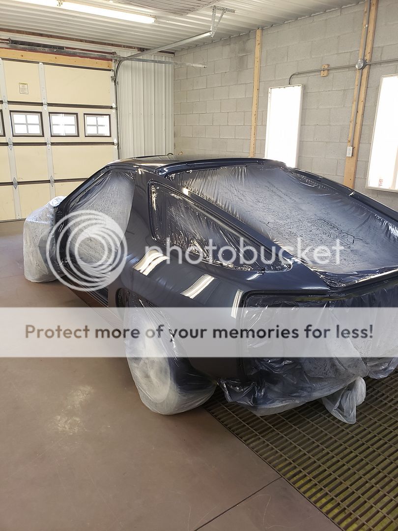

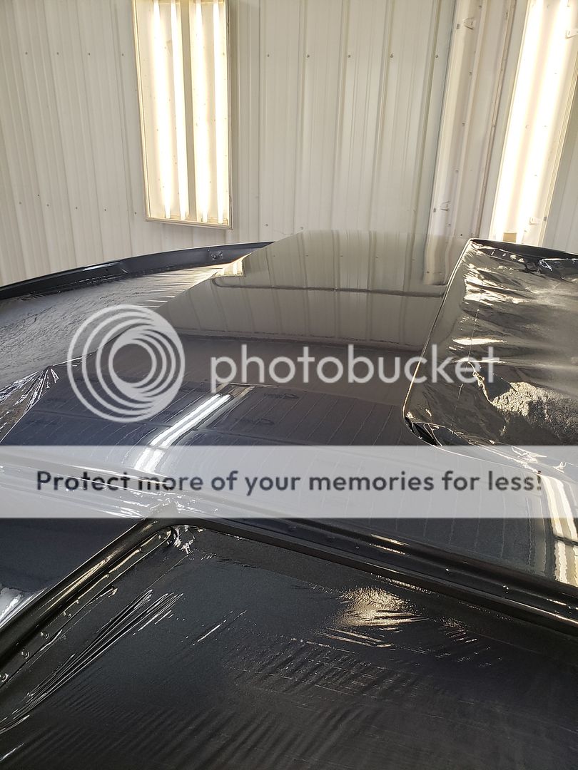

Teaser pics!!! More to come..
I think I have grossly underestimated the beauty of this color (Prussian Blue - 33X) when it is as it should be.. Guarded by a deep, crystal clear film of Glasuirt clearcoat.
