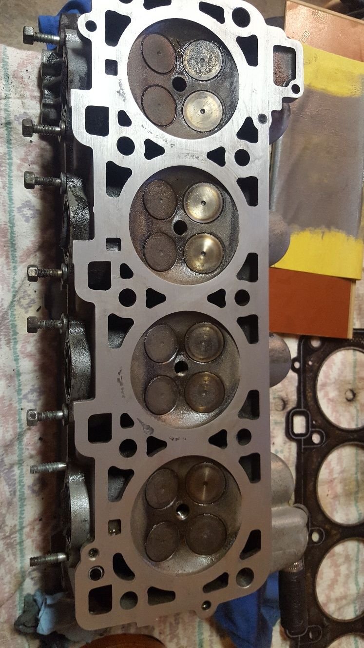

These aren't the bad ones.
I know I will need to JB Weld the pitted spot
Pic of the motor / engine tore down

best bet is to have the head welded JB weld is a last resort for this surface.
NOTE read the WSM before you do anything to the head so you can see how much surface is available for cutting
lifter and cam lobes all wear into each other.
swapping them will change the wear curves of the parts thus making the wear increase rapidly.

The spot that needs filled is not a sealing surface of the head. It is by a water jacket that hits the gasket and does not go through. A machine shop I trust said, I could just leave it as is or jb weld the pitted spot. JB weld is good to 550 degrees. This head shouldnt get over 230 degrees.

https://rennlist.com/forums/928-foru...corrosion.html
I also found this thread to backup what the machine shop and my logic was telling me. Again, not a sealing surface.
