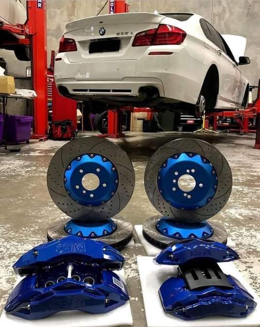

I think I have this solved. I hope I do because it's about to be ordered. If it works I'll end up with 380x32 front rotors with 8 piston calipers and 356x28 rear rotors with 6 piston calipers. If it goes to plan it all fits under an 18" wheel.

I've used their template on the back for the 356x28 rotors with 6 piston. There was roughly 22mm additional clearance. All else being equal I need 12mm to fit the 380s so I'm hopeful. I'm using apex wheels and they're said to be designed with brake clearance in mind.

Wheel flex and clearance of weights shouldn't be an issue, just diameter. The Apex wheels I'm using are both rear wheel fitment due to the widths I'm using. 11" front and 12" rear with 295/30 and 315/30. I'm looking at Cieka calipers and rotors.
