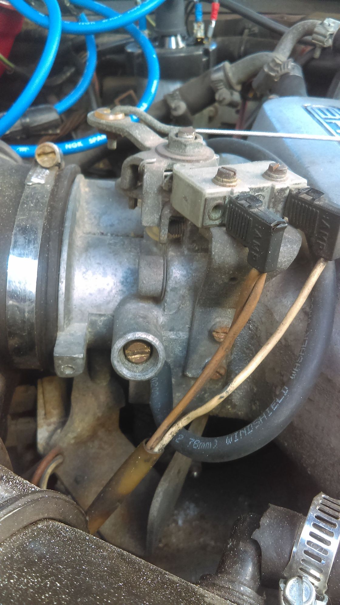

My mistake, the 3mm Allen key adjustment is actually just behind the fuel distributor, bit of a user error there. But here are some pictures, one with a view of the bay, one zoomed in on the flat head adjustment screw on the throttle body, and one of the previously mentioned Allen key adjustment behind the fuel distributor.

this should help somewhat....
at one end of the lever is the big plate you see under the boot.
at the other end is a plunger that restricts the through-flow of fuel in the distribution block part.
the idle screw adjusts the relation of the plunger vs the plate in closed position...
for really good help, i suggest you check 924board.org...rennlist doesn't have that many 924 folks, its mostly 944 on this side which is totally different engine-wise/fuel injection-wise.
those guys are CIS-wizards...

Thanks for that, that does shed some light. So using the diagram's terms, it looks like idle mixture control screw adjusts the resting place for the sensor plate lever, thus adjusting the resting place for the sensor plate itself? And in terms of the idle bypass screw, should that be tinkered with? From our observations, it's necessary to adjust that accordingly with the idle mixture control screw, but I just want to be sure we're not going to mess anything up by adjusting it. Also, any ideas on why the system would go out of tune, having a tendency to begin to run rich after a couple of weeks?
