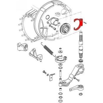

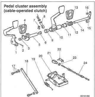

Hi..it could be several things...What is not normal that you cannot pull it back.That would point to broken pin on the pedal cluster cross-shaft
number 2 on this pick
Then it could be you helper spring on clutch arm number 19
The next thing is your omega spring at the clutch arm by the transmission is broken
http://forums.pelicanparts.com/uploa...1311856645.jpg
and least ,it could be your fork which controls the t o bearing...
http://forums.pelicanparts.com/uploa...1282597534.jpg
Ivan
i c the photos try to pull back with a screwdriver the Omega spring arm ...looks like inside the clutch problem the fork

Hi Ivan, Thanks, When I pull up the clutch pedal it goes back down to the floor position, very odd, nothing seems loose or broken in the pedal cluster so I don't think there is an issue with the pedal.

Had the same thing happen to my 78sc,fortunately in my driveway. Turned out that the roll pin that attaches the cross shaft to the clutch pedal snapped. Removed the pedal assy and drilled it out for a bigger pin. Proporsche posted a drawing for you, as he quoted, part is #2
Good luck

Cable runs off the end of pictured assy down the shift tunnel
